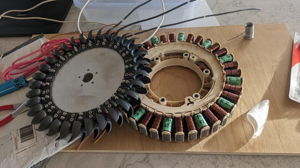

Through the amazing resources available on thebackshed and others I have gathered the needed parts and bobbles and am rewiring the SmartDrive stator to suit my site and system (3P4S with provisions for either start or delta). I bought what looks like a pretty decent pelton wheel on eBay and have 100m of 75mm hose to go from the source (a culvert, really...) to my turbine.
Next I'll assemble the turbine & rotor together reusing the shaft of the washing mashine to attach the pelton to. Does it make a difference which direction the rotor turns? IE I can attach the pelton so the rotor turns clockwise or reverse - does it matter? I can't seem to see anybody specifying this in their videos so I'm guessing either works but not sure...

No it shouldn't matter which way it turns, unless you're using the 3 phase power directly, and even then it simply reverses the phase sequence which is easy to switch back electrically.
If you're rectifying the output to charge batteries it won't make any difference.

This one is a 36 pole stator which, as I understand, has much less cogging. I also considered the great calculators on powerspout.com to determine the best wiring configuration for my site, and they do cover spacing the rotor out and star vs delta as things that can all help getting the rotor moving...
