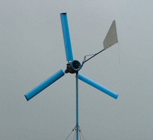

Posted: 09:21am 16 Apr 2009
Hi Dom
I'm looking at a few options.
1. Waterjet/laser cut parts to my design, from 6mm mild steel, will cost about $140 ex GST, plus the U-bolts and delivery.
2. I'm going to see Trev next week to discuss a cast alloy hub to suit the 25mm blade mounting rod. A cross between his existing F&P turbine hub and his aircraft propeller hub.
3. Draw up a design that could be made from common steel sections
4. Make the CAD files for option 1 available on the web site, so anyone with access to a laser/waterjet cutter could get the parts made themselves.
If Trev can come up with a hub, then I think that would be the way to go. All options will allow easy adjustment of the blade angle and either CW or CWW rotation.

Posted: 03:03am 28 Apr 2009
Glenn,
As has been suggested before, why not ask Trev when you see him is he is interested in casting/machining a Jacobs-like variable-pitch hub. The one-inch tube could rotate inside another tube or hub with a spiralling cut, where the inner tube is rotated once the centrifugal force tries to slide the spring-loaded blade outwards.
A slider attached to the blade tube would follow the spiral and rotate the blade into coarser pitch at higher wind speeds right up to feathering.

Posted: 11:54am 28 Apr 2009
Dom,
The twisting is not the problem, it's the synchronising that matters.
If Trev were to do something with this idea, it would be far more productive to build/cast the spider and matching blade holders.... just leave the outer to rotate and slide on the inner rod (maybe 500mm long). Use the spider and the blade gripping thinggy (and ball joints), to control the twist and synchro problems.... would be a beautiful setup.
In my humble opinion, this would make these blades a must have for those wanting a good reliable idiot proof variable pitch...... M. Jacobs knew his stuff.
.........oztules

Posted: 10:09am 30 Apr 2009
Regarding freight, at least within Australia, then using the bus freight system I believe would be cheaper and
they would not worry much re the length. They do carry lots of lengthy items such as surfboards, fishing rods,
bikes etc. Three blades in bubble wrap would be a very secure package setup and not likely to damage them.
re the variable pitch am thinking a heavy coil spring in tension holding the blade at an 8+- degree pitch with
adjustment and as wind increases blade rotates tension spring into higher pitch until finally feathering.
Tension spring will be fitted to end of 25mm SS and MS internal shaft and locked between the ferrule on hub and
washer and nut on end as per Anthony's hub setup.
Ferrules may have to be a little longer and would be lubricated so as to move. Springs can be wound and
shaped in MS and heat treated to correct tension. No problem....
