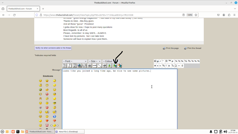

Looks like you joined a long time ago, be nice to see some pictures.
You can use the upload image,
Cheers Aaron
