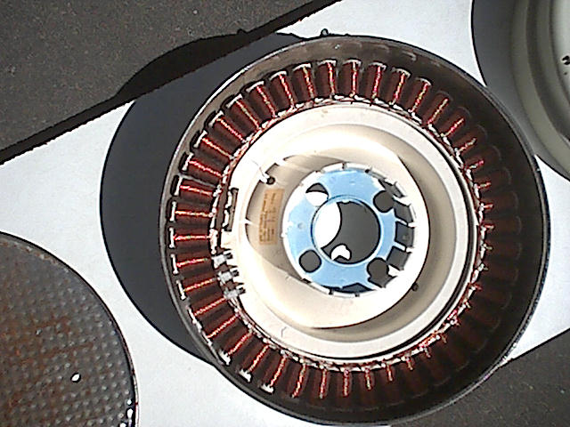

Re Matt Lyons Neo rotors (previous board)
What do you expect the magnets would cost you for one rotor if you did the config you’re talking about (56 30x10x5mm neo’s)?
60amps @ 14v ~ 800+ watts is darn good we all hope you succeed, what would you estimate the average power would be.
I'm planning something similar and also toying with the idea of using a metal rotor, the F&P stators are excellent but the standard rotors are average and inhibits potential, bellow is a pic of an old flimsy cake tin though I'm think I can get new thicker ones from department stores maybe these might work, anyone got other ideas?

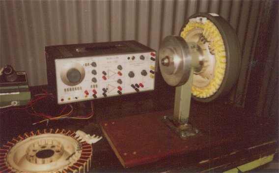

We played around with using the F&P as a motor to drive a solar car about 6 years ago. This is our test rig, with a standard hub.
The stator on test was rewound with 4mm wire ( yellow insulation ). To increase the output power we had a new hub cast from aluminium.

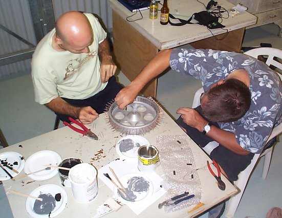

You can see it here with the new rare earth magnets getting glued in place.

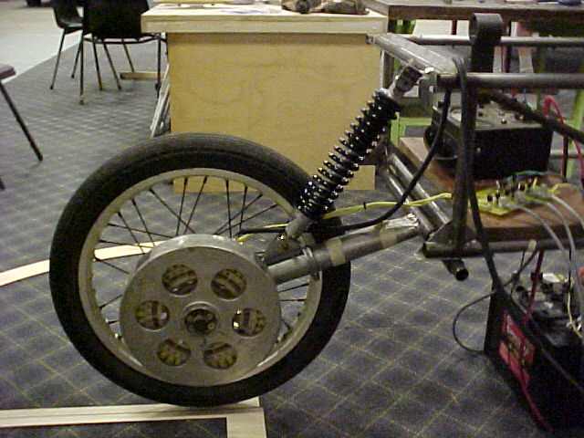

And on the car. The motor had great potential, but we gave up after a few months, had too many problems with the drive circuit, kept popping power mosfets. Ended up using a DC motor and drive chain.
