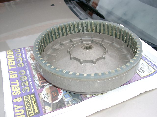

do smart drive motors have neo magnets in them?
if no, what kind of magnets do they have and what would happen if i put neo magnets in them?
Posted: 10:40pm 15 May 2006
No they dont, they have ceramic magnets.
It is possible to convert them to Neo's, and this will almost double the power output. Look here - http://www.thebackshed.com/Windmill/Articles/MattLyons.asp

Matt Lyons visited my place some time back and we stripped a Ceramic rotor and retrofitted some Neo's he bought up with him.
He angled them slightly and after they were lined up _they magnetically stick to the steel backing in the rotor,so that's a help- we then mixed polyester resin and poured it into the small spaces between the magnets by making a "dam" with Gaffa tape around the inside of the rotor.
They seem to be very powerful on my stators-almost a 2 man job to pull the bloody thing off the stator, but I'm a bit concerned with the cogging ,still too much,I reckon.
