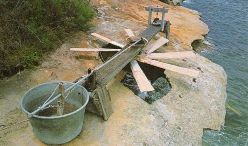

How about a wind power washing machine....
Photo from the book "Home Made Houses" by David Liddle and Ann Taylor.
Posted: 02:25pm 04 Aug 2009
  Gizmo said   How about a wind power washing machine....
It took a while to figure that one out
"blow hole effect"
grub
Joined: 27/11/2007
Posts: 169
Posted: 09:39pm 04 Aug 2009
Yes, I see it now. I originally thought that the mill was lying down for maintenance or some such thing.
Aren't some people just too clever.
