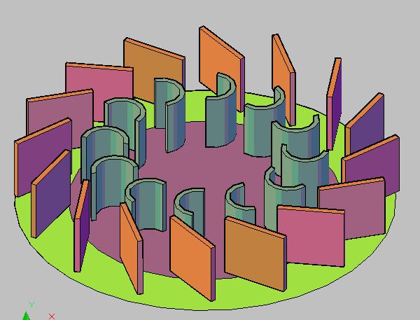

I have been thinking of a VAWT design, as always its a
drag based vawt. my query is do increased height of
blades do anything for the mill. If blades are longer,
they will make it easier to catch wind, but at the same
time the opposite side (drag) will be increased as well.
Also a longer blade would make the mill heavier, and a
little more fragile in my opinion.
I guess i'm really looking for an efficient way to guess
what height would be good, for reference I do not really
plan on putting this VAWT on a post/tower, id like to
keep the design ground/flat rooftop based.
On a side note, i'm guessing that the larger diameter of
the base and vanes is the bigger the better.
Let the conversation begin, and i'll reply back as
needed.Edited by screwball3z 2009-08-01

Just to give an idea of what i'm thinking about here's a
rough sketch of what i'm thinking about, the outside vanes
are stationary
Edited by screwball3z 2009-08-07

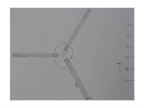

Roel Bos
Joined: 15/08/2009
Location:
Posts: 1
Posted: 06:37pm 14 Aug 2009
Hey Screwball,
I'm a newbie as well and have a similar idea, cause my neighbours inevitably will complain as I live in the Netherlands.
The idea is to fabricate one VAWT with blades of 1 meter made out PVC pipes, sliced in half in lenght.
It will be like an anemometer with three blades and I'll place it on our shed with a flat roof or just the house roof where it will charge a battery.
I have no doubt it will rotate as I experimented with a smaller one, but the only issue is
The only issues I expect are the speed of it and what kind of motor I should use.
As to your questions: I don't know how to calculate all factors, I'm just going with my instinct.
I think the bigger it gets the slower it rotates, but some gear can overcome that (and reduce the momentum/torque).
The drag will always be present, but the factor between thrust and drag will be the same, according to the shape of the blades.
I made a simple picture(yes, by hand) Hope it can tickle your imagination.
Greetz,
Roel
Edited by Roel Bos 2009-08-16
