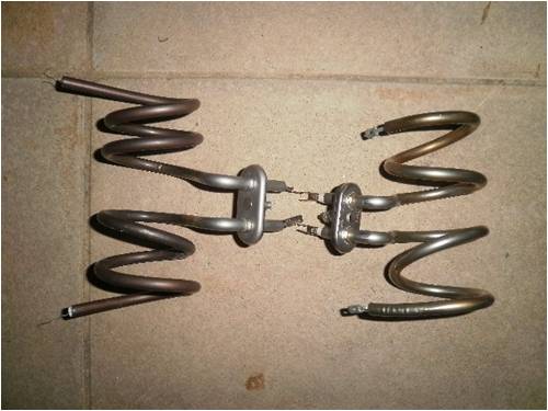

Anyone know where I could get some DC water heater elements? I would like to set my dump charge up to generated heat in the water of my outdoor wood boiler that currently heats my house and hot water.

A pure resistance water heater (is there any other kind?) will not be bothered about AC/DC. Just work out the voltage and current concerned and use Ohm's Law to choose a suitable resistance and wattage for your heater. Or just post the figures here and I am sure there are members who can give the answers. Edited by KiwiJohn 2009-12-10

check out the article from the homepage on encapsulated resistors.
They are free (used dishwashers is my preferred)
Cut to length as required for the dump Volts x Volts / Ohms = Watts the resistor will use.
Easy unless you are immersing it in water then will need some more effort to keep water out of where is shouldnt be.

I need to hunt down the kind that thread into a PTF (pipe fitting). My tank has plugged coonections at 2" that will work great.

You can bend an element and silver solder it into a 2" ball plug with 2 holes drilled in it for the element to pass through.
If you can find a long element with a suitable bend already in it. than you could shorten it up to suit your wattage requirements.
It will make little difference if it is out of a stove, dishwasher urn or what ever but i do think the dishwasher and likes have a slightly heavier outer casing.

I didn't know they could be bent. I was thinking I had to find somthing that was pre-made.
