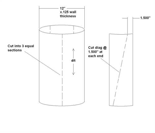

Hello cobo351
I made my blades from aluminum tubing.
see below. Im sure there are more efficiant designs but I am very happy with the performance of these. kinda shot from the hip regarding size and pitch but the turbines spin up real easy and crank like no tomorow in good wind even with the 3 phases shorted out at 28 amps.

Dupa, the trouble I having is finding tubing metal or plastic in 12" size. I'm building a wind turbine right next to you.

Posted: 05:44pm 18 Dec 2009
Here's where I found my chunk of tubing . )Gand Rapids Scrap yardSometimes they have somthing sometime they dont. Just need to call in often and check. Dont be too specific regarding dia. If you asked for a specific size they may say they dont have it however they may have somthing thats within a 1/2 inch and still usable.
I did have a piece quoted by EMJ Metals
For about $200 for a 4ft section. (you can get 6 blades from 1pcEdited by Dupa 2009-12-20
