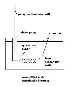

A practical horizontal axis turbine system may be possible using an old well pumping system where a crank at the tower head raises and lowers the pump rod, the pump being something akin to a hand car or even bicycle pump. Note that the outlet valve is a pressure release type adjusted as high as possible without causing the windmill to stall.
In theory ambient temperature air is drawn in around the pump piston then then pushed through under pressure into the heat exchanger coils. The compressed air is now hotter than ambient and gives up some of its heat to the surrounding water. As the air is released through the outlet valve its pressure is reduced but now the air is colder than when it went in so energy has been recovered from the atmosphere. Immersing the whole apparatus in water ensures that all friction losses are put to good use heating the water.
Is anyone interested enough to try this out?
I expect that in practice it will be more effective heating a larger amount of water just a little rather than trying to bring a small amount of water to the boil.Edited by KiwiJohn 2006-07-20

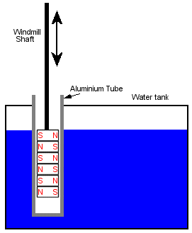

I like Ed's ( Windstuffnow ) idea, "Ed"dy currents.
See the drawing...
A set of tightly packed alternating magnets are suspended inside a aluminium tube by the windmill drive shaft. The tube is blocked at one end to keep water tight, and mounted into the water tank, as shown. As the windmill dives the magnets up and down, they will generate a bucket load of heat into the aluminium pipe. The faster the windmill, the more heat generated. And there is no starting problem as there is with a compressor, at slow speed the eddy current load will be small, where a compressor may have to push against a back pressure.

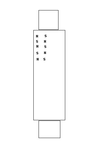

Gizmo: recropracating (?) motion (up and down) is ok, but you have lots of moving parts, and a HAWT.
What if you kept your original idea in as much a a large copper/aluminium tube, but stick it on the end of a VAWT and re-arrange the magnets so as it spins around its axis there is the same rapidly changing field?
Posted: 06:00am 19 Jul 2006
Like this you mean...

  Gizmo said   Like this you mean...
'zackery!
And you could stack magnets vertically up the shaft to make it longer, thus imparting more energy.

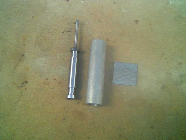

              Well after reading this post I got the bug and I'm making up a prototype. The photo shows the shaft I've machined up and the alu tube which is 1-1/2 diameter with a 20 mm bore. I've machined the shaft to 19.8 diameter so there will be .1 mm clearance on the radius. I've got 140 odd 3x3x3 n40 neo's which I intend to embed in the shaft so they sit flush with the top. Now the question is which is the best way to arange the magnets? I was thinking of North- South vertically and have the magnets sitting next to being the opposite pole. I reckon if I get it right it should make a beaut immerson heater and I can trial different rpm for temperature measurements.
In the arragment shown below is my idea but I'll need some advise whether this is the best way.

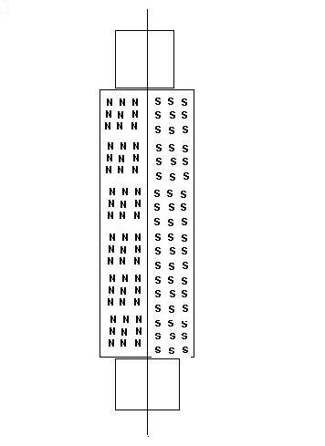

Bryan, I take it you are going to rotate the shaft (i.e. not reciprocating)?
I think it would be best to have the magnets in parallel, that is with all the N poles adjacent and of course all the S poles adjacent, Making in effect just one big magnet.
My reason for saying this is that you want the lines of flux to travel through the aluminium but if you have the magnets side by side a goodly portion of the lines will join through the touching surfaces of the two magnets and quite a few will squeeze through the .1mm gap too.
Bryan1
Joined: 22/02/2006
Posts: 2297
Posted: 07:22am 23 Jul 2006
Hiya KiwiJohn,
               Is this what you mean, basically cutting thru the centreline 1 side is north and the otherside is south. Or would be better to do the poles in 90 degree quadrants?
