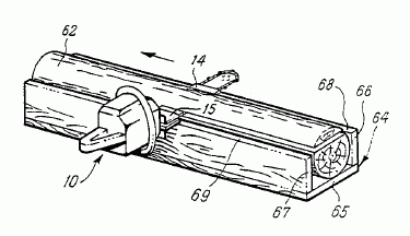

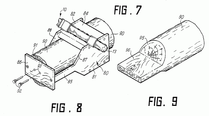

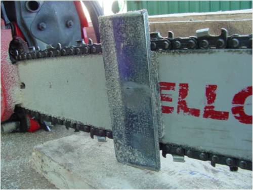

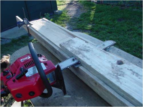

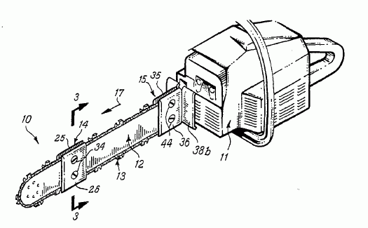

Don't worry, Greenbelt, we all re-invent the wheel sometimes. It happens to the best of us....
[quote=Oztules]I thin unless your investigating particle physics or similar..... it's all been done before.[/quote]
Indeed it has been.... Oztules, it is with some pleasure (mischievous pleasure!) that I'd like to show you US patent nr. 4858325, called 'chain saw and guide', from 1989..... Here's an extract:
"This invention relates in general to a hand held, portable self driven chain saw of the type used to cut wood. More particularly, the invention relates to a chain saw with a guide attachment mounted to the chain bar which extends beyond the saw chain and shield the saw chain so that the guide can engage a guiding surface as the unshielded portion of the saw chain cuts a work product.
Chain saws have been utilized for rough cutting purposes where the relatively unskilled operator can cut. [...] Although the above noted advantages of the chain saw make it a highly useful cutting tool in rough cut situations, the chain saw is not very useful by the average operator when very accurate cuts in a wood product must be made.
Briefly described, the present invention comprises a chain saw and guide which permits the chain saw operator to accurately use the chain saw when cutting wooden objects."
(Oh, Oztules, you can't possibly begin to imagine how much evil pleasure this post is giving me....)
I hereby present some visible material, rather than the dry legal text from above:
vs.
vs.
And a direct link to this invention from 20 years ago: http://www.google.com/patents?id=f1E3AAAAEBAJ&printsec=abstr act&zoom=4#v=onepage&q=&f=false
So there you have it Greenbelt... reinventing the wheel happens to the best of us! Nothing to be ashamed of.
Without joking this time: there's a wealth of knowledge in the patent databases, just waiting to be re-discovered and applied. A few years ago I did some searching on yaw- and pitching mechanisms. Got results on elliptical pitching (what we are using nowadays on our axial fluxes) that went back to around 1780, IIRC.
It's all there. Greenbelt, do a google patent search for 'vawt' or anything else that interests you, and be surprized about what you will find. You will get more ideas than you'd care for. And you'll see that there seems to be *very* little that hasn't been thought of before....
And w.r.t. to Oztules' chainsaw guide idea: often the guy that ends up in the history books is not the one that invented something, but the one that managed to apply it and spread the idea. And there's nothing wrong with that - on the contrary. If we humans had to invent everything we did from scratch, without being able to build upon the work of others who have gone before us, we'd still be using wooden sticks to poke in beehives to gather some honey....
They often say that 100 hours in the shack/shop will save one hour in the library....
Peter. (<-- walks back to the shop... thinking about how I never even RE-invented the wheel....)

[quote](Oh, Oztules, you can't possibly begin to imagine how much evil pleasure this post is giving me....)[/quote]
Oh yes I can..... you forgot this bit..
That Edward A Miller was obviously a superstar, hero and all round good bloke to think of something like that
Sigh...I just can't believe the similarity....Just one more thing I have RE-invented.
Gee those old boys with chainsaws have done everything too
