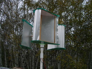

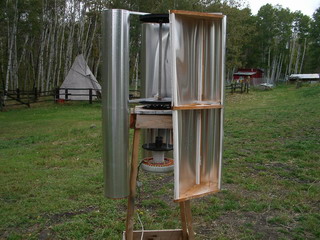

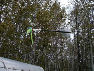

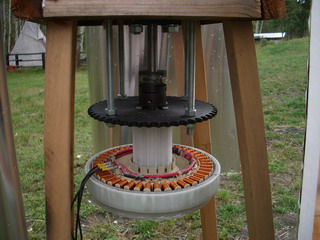

Its been some time since I posted something here. Here are some of my new pics. The mini Lenz are Ed's MiniGen's that work very well and good trickle charger's. On the big FP Lenz I used a coupler. It a bad location and to many trees, will move soon.

Posted: 08:52pm 21 Sep 2006
Looks good Wayne.
How do you find the Lenz and F&P combination?

Posted: 09:05pm 21 Sep 2006
Hi Glenn
It seems to turn very well once it gets moving. I find no noise and more from Lenz blades sheeting. The tower is not good and blades come a little to close right now. I wish I had a welder but only small lathe. The shaft FP was cut and sized down to fit coupler. I did the best with the materials I could get. For the real output will need a suitable location and new tower. The FP are very hard to get in Canada and are amazing generators, wish I lived there.
