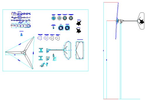

In Annex I attach my whole project with Autocad

Do you have the Autcad files as a ZIP?
SpitsFire
Joined: 09/10/2010
Location: Italy
Posts: 11
Posted: 09:15am 09 Oct 2010
  Gizmo said   Hi SpitsFire
Nice windmill
Forgive me here is the file
2010-10-09_191521_Progetto_turbina_2Kwp.rar
IPSA SCIENTIA POTESTAS EST (bacone)
Posted: 11:07am 09 Oct 2010
Almost, here I've done it for you.
2010-10-09_210630_Progetto_turbina_2Kwp.zip
Its a DWG file, very good.
Thanks for posting.

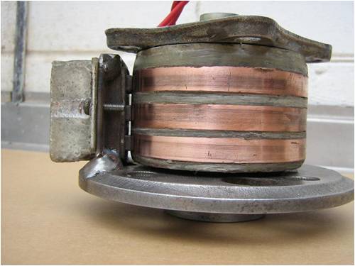

I can only agree with all that has been said, a Job well done. I have built a 500W windmill of similar design but this has inspired me to go for a bigger unit and looking at those nice pictures gives me that extra push (I hope) I have always wanted to include slip rings and you make it look so easy. I was thinking of using car alternator brushes and copper pipe cut into rings cast with resin, but your idea seems repeatable. I will look at the Autocad files tomorrow.
Now just imagine....MPPT with this turbine.....
Thanks a lot.
Leon
ZS5QY
Happy Solarwinds
Downwind
Joined: 09/09/2009
Posts: 2333
Posted: 02:38am 13 Oct 2010
Funny you should say about using copper pipe rings set in resin and car alternator brushes.
I just finished a set of slip rings using all these things.
Pete.
