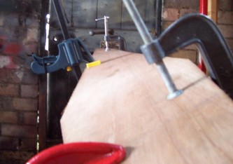

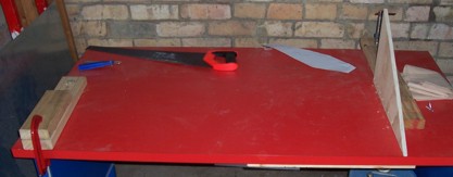

G'day guys I've been trying to come up with a way to make twisted blades that doesn't require too much carving. I found it nearly impossible to get a piece of wood big enough to carve a decent blade that didn't have knots all through it. So I had this idea from my previous boat building work. Unlike building a boat this wood is unsupported so it just a try and see how it goes sort of thing.

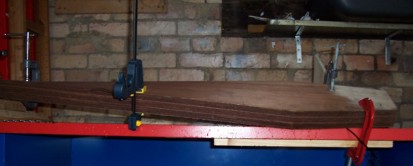

I started with 19mm marine ply 1200mm by 600mm and cut an elongated coffin shape out with the middle one up side down to maximize use of the wood.

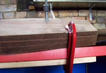

I then left them to soak in a wheelie bin full of water for three weeks. I made a jig on a bench to clamp them to, clamped them in and left to dry, so far about 4 weeks drying.
Now comes to the bit I'm not sure of, I think I'll carve the aerofoil shape on them and poly resin them to seal from the wheather, I think resin would be better than paint as it should soak into the wood a bit and possibly help them hold their shape. It's also a bit more durable I think.
Any suggestions ?
PS if your wondering why I twisted it like that it's to fit the alum prop hub made by Trev
BTW the wood cost $30Edited by Highlander 2006-12-20

Great idea, though you already suspect the potential week spot I see, being not holding shape over time. With boat building isn't this twisted panneling secured to a frame and or other hull structures to maintain it's shape? Unsupported, any return to it's origonal flatness would cause most trouble if they were to not untwist at the same rate. Still worth a try. Though I would suggest laminating several thinner sections where they were glued and clamped to the desired shape. I saw a yacht built where with the first layer of ply, the ply grains were say verticle and horizontal. The next layer was diagonal then back to verticle and horizontal for the 3rd layer. Not very economical use of ply sheets, yet thats how it was done and the curves involved were not gentle. With the setup you have now I think the resin idea is better than paint, but fiberglass the lot as painted on resin will crack with heat expansion then the water soaks in. I like the basic idea though.

The Polester resin will not like the timber especially if it has any moisture at all in it. Epoxy resin in a dynal cloth would be better and the dynal would help to hold the shane of the blades and give more strength.
In the event that your ply blades are not successful try shaping some polyurethane foam and fibre glassing with polester resin and place timber only at the area of blade where bolts fix to hub.
The foam is very easy to shape and very light but the strength come with the FG.

I did consider using multiple sheets laminated but it adds an incredible amount of time and wood, basically I was looking for a quick easy method. Only time will tell how they hold up.
I think after time they will revert back to a flatter shape, but with centrifugal forces they will probably do it at the same rate. If they don't they'll vibrate, break off and fly into the paddock (big deal), but considering for $30 plus coating, if they only last even 6 months then they're still good value. I probably wouldn't try this in the suburbs though

If they can be waterproofed so no moisture gets in it should work. I expect that they may flatten out a little when first removed from the clamps. After they stablize and then are waterproofed they should be fine. Moisture will cause it to remember its old shape if not supported. Resin and a binder(fiberglass or other) will act as a limited support and waterproofer. I did not have trouble with fiberglass patching on dry wood but usually roughed it up a little with sandpaper.

The marine ply will flex back a bit after being declamped, I added another 8 degrees of twist to allow for this.

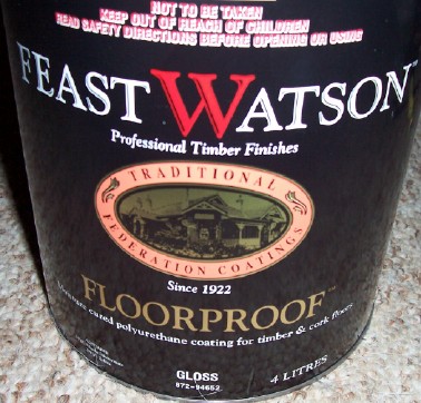

I went to a fibreglass manufacturers trade outlet today and he said "mate I'de love to sell you something but the best product for this application is moisture cure urethane, which you can get at a flooring/paint shop."
Apparently this stuff soaks right into the wood adding strength and completely seals the surface. Perfect.

If anyone else tries this I cannot stress enough that you need to soak marine ply for WEEKS about three is good. If your in a high humidity area you may need to build a box surrounding the area and insert a heat source when your drying them.

Hey Feral I understand your concerns, but they have been drying for 4 weeks so far, and I was planning on another week more with the heater in the box surrounding it. So they should be bloody dry after that. In the event that there is still moisture there, the moisture cure polyurethane should work just fine. Here's a close up of the can.
This will also cure from moisture in the air and doesn't use glass or other reinforcement as it's a coating.
Trev I noticed a FGI can in one of your pics, they're the guys that advised me to use what I bought.
FGI being a manufacturer with their team of chemists and R&D facility would have been the best ones to consult, I thought. I went to the Melb plant (not a reseller) and a few guys were involved in the discussion and that was what they all agreed on. So if they're wrong, God help me, and I'll try something else.

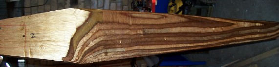

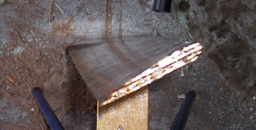

Well the blades turned out well.
They did lose a bit of their twist after the carving of the aerofoil shape was done. The wood which was removed must have been holding some of the twist. It would be better to cut the shape out, carve and then soak and twist. But if you do this you can't stack the blades on top of each other when clamping, due to the wing shape on the blades. So three separate jigs will need to be made for them to dry out in.
I did find a better coating, it's called "spar marine" made for high uv and tough marine conditions.
Yes this is totally experimental. If they hold up well then it's a bonus.
