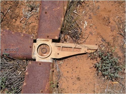

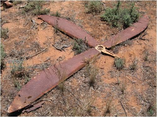

Was walking through the scrub last year and come across a 4 blade hub with galvanized blades still in pretty good nick but no tower or genny so no idea what it is.
I have a lincoln tractor pac that puts out 32 volt. there are some seriously heavy duty bits of kit that it drove, I remember drills that looked like jackhammers that could break your arm if you were not careful.

I can probably find a G51 hub and Genny, the blades look like a regular version, not one offs for low wind. Bit busy at the moment. i remember seeing a lot of four bladers in the early 70's but I was too young to know what I was looking at, people called everything "freelite's" then.
they have deteriorated a lot since I last looked! I might ask If I can pick them up, need to brace them to move or they will fall apart. Any ideas what they are, its a cast hub with a steel insert?
Edited by yahoo2 2011-11-21
windhistory
Joined: 14/11/2011
Posts: 8
Posted: 08:25am 20 Nov 2011
Hi , the blades pictured are Model L 750w Dunlite. These are the earliest curved version.
You could possibly find replacement blades , but they would need repair and come from diff
machines. The days of finding a box of unused ones (curved version) are probably long gone.
The hub would need rebushing i think after cleaning up the rust and most of the blade bolts
may have to be punched out and retapped. Try to keep one blade intact for a pattern.
I would love to obtain a G51 ...at least the gearbox which is different to earlier models.
