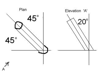

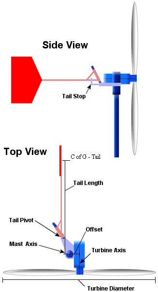

Please note the Tail Length diagram is incorrect also. It should be:
This sketch may also be of assistance:
Let us know how you go with that please.

I have the tail moment as being: TAIL MOMENT= TAIL LENGTH x TAIL DRAG. It seems logical that the pivot angle should be included though, so what should the working formula look like?
I also agree that nominating a tail length & pivot angle to get the tail weight is more practical.Would the Tail Pivot Angle formula be arcsin(turbine moment/tail lgth/cos(45)/tail weight)/B]?
