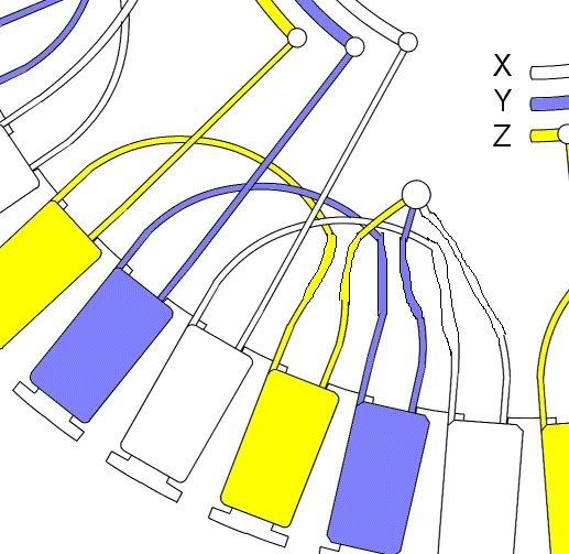

this is what i was supposed to do
this is what i did
can anyone suggest a way to repair this with the least amount of rewiring possible?Edited by makourain 2007-02-18

Ouch! I kinda know the feeling.
You already know what you've got and what it should be. Just a matter of bighting the bullet and getting it done.
One other option you have is to turn it into a Star/Delta configuration. This gives you the ability to change from Star to Delta and back again by moving a couple of links, no having to have two seperate stators.
You seem to be a fairly inventive so even if Star is the configuration of choice it would be interesting to try out Delta to observe it's charestics for yourself.
The other thing is that rather than repairing a stuff-up you are improving by making your project more versitile.
The repair will be quicker but maybe the upgrade would be more fun?
It's just a thought.
Good luck with whatever you decide, and post a pic or three when its humming.
Cheers Gill _Cairns, FNQ

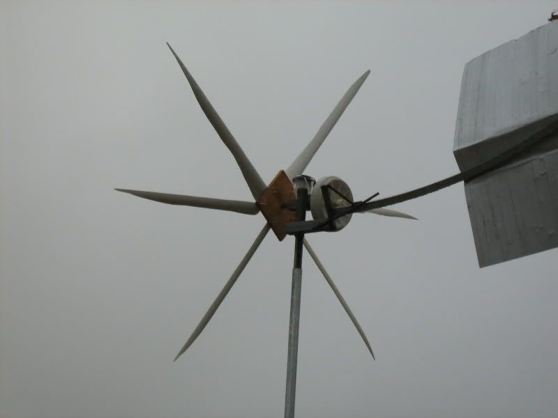

smart drive mill number 1

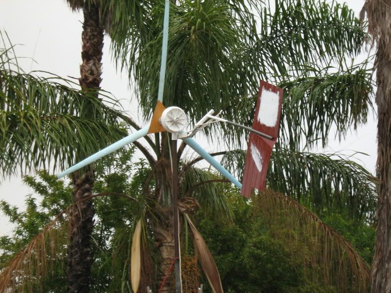

smart drive mill number 2
I am currently working on smart drive mill 3, I have decided to make it in to just a delta.
gill: thanks for your help.
