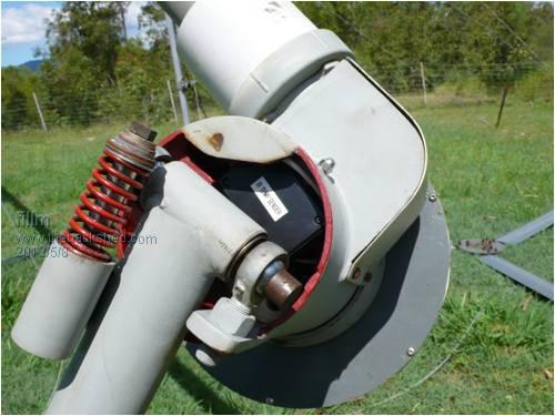

In the pressure of the moment as a lull came through I threw the shorting switche’s , the AX300-2 did not stop, but instantly went into an unloaded state and as the gusts came the blades were reaching RPMs that were sphincter clenching.
The mill could not furl as gyroscopic force had taken over, and I could only watch on from a safe distance, and trust my engineering .
The blades and hub handled what I would think was in excess of 1200RPM peaks at times.
The sound from the blades resembled an aircraft doing propeller checks and a helicopter landing all at one time, anyway the blades and mill survived structurally .

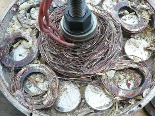

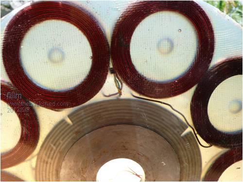

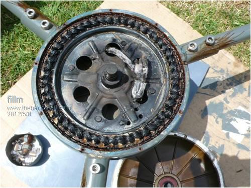

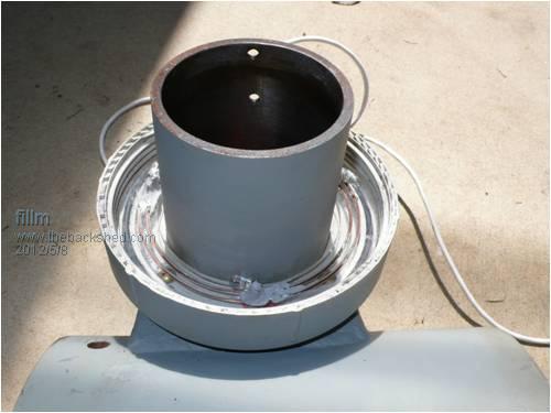

The smaller mill also burnt the stator and windings, but due to the iron core and shorted windings eventually it came into a stalled state.
Below are a couple of pics of the destruction, but I do not want to dwell on it, or go into any lengthy debates on the “whys/what’s “ and in depth of that.
Ax300 Stator a bit worse for wear, smashed,chewed up, and bird nested .
500W Kit Stator Cooked- High Temp Silicon wire is crispy.
As This has now been my 2nd AX melt down / Blow up or whatever you want to call it, and also the 2nd 500W melt down, I needed to seriously reconsider how the mills are controlled in high wind situations.

But there is a downside to this. When the mills are shorted out to brake or stall the mills, the doublers are bypassed and causes the original wiring configuration to dissipate the heat generated from the power of blades, this means that when stalled using a shorting switch in high winds, the blade rpm can reach a point where a fair/large amount of power is being produced in stall which has to be dissipated as heat, due the GOE222 blade because of its high torque low RPM capability.
With shorting the phases the energy is dissipated internally in the stator, (with some additional loss with line resistance) causes the coils to overheat and expand rapidly, which is not good for epoxy encapsulated windings.

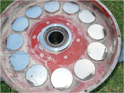

Another anomaly I picked up and is limited basically to this particular design of enclosed stator type AXFX, is that both times it has burnt a stator, the stator was forced in one direction towards the front magnets, I had not paid too much attention to this, but while I was assembling it for a clearance check I remembered that it have a slight misalignment
of about 10mm with the magnet plates, that happened due to a bit of a mistake when I originally built it, for the last 40mm when the two plates are lowered together it required alignment rods to align the bolt holes, this really is no different than decogging for an AxFx and the flux lines are angled as they cut the coils.
As Both Gordon and myself built these similar AXFX alternators 3 years ago it has always been a mystery to why mine was so quiet and barely makes any noise, as its quite common for AXFX designs to have a growl at cutin and while producing power.
This then identified another problem I think could be happening, being as the stator gets warmer and more flexible the force of the angled flux lines constantly forces the stator in one direction, and eventually causing contact with the magnets, and more so when shorted or loaded heavily.
Resulting in both burn outs having made contact to the same areas on the magnets
Contact on front Mags
I was going to re-align the holes so the flux lines are at 90deg to the windings to stop the flex under load but decided not to, and give the front air gap a little more clearance, as having a quiet generator is a good option, with the mill location being close to the house.

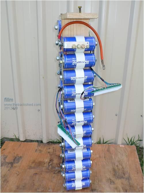

I installed a 25 X 3000Farad Cap bank in parallel with the batteries to absorb wind gusts and solar bursts, as there is very little A/hr absorption in the Batteries as they are constantly held @ 52.3V due to the cut off point for the inverters.
The Caps will absorb approx 8000W in 30sec, since they were added the spikes are slower and smoother.
25 X 3000F 2.7V Ultra Caps
In this situation it is very hard to size a dump load that dumps excess power from the batteries, so it is a better option to use a diversion load for the mills and use that to stop the power from the mills completely when the voltage is high, or the grid is down, or the inverters are lagging.

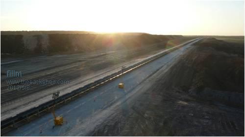

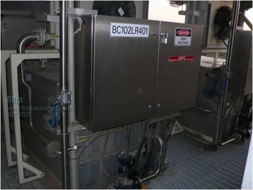

With all this to consider I have had an idea in the back of my mind, it has come from my present work place, where the machine I work on and operate uses a system called a "Liquid Start Resistor" to start Conveyor belts for a 12000TPH Crushing and Conveying system, that shifts overburden at the mine I work at.

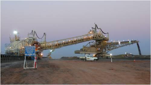

Each of the two main belts , one which is 2.5km have 4 x 1200kW motors that need to start slow at high torque and slowly ramp up to full speed of 5.8m/s , this is done by the Liquid Resistors that basically have two sets of annodes in a tank, basicly one set are moved closer to the other by a drive motor untill there is no resistance.
The tank is filled with over 1000L of liquid with high Ph. Basically very salty water.
When starting under load over 1 megawatt @ 1200V x 4 is being passed through each
of the liquid resistors and excess power is dissipated into the fluid. These monsters have cooling pumps and fans and you only get 3 consecutive starts before having to go into a LRS cool down time out.
Below are a couple of pics of these units and what is being started .
Spredder
2.5Klm Conveyor
High Voltage liquid start Resistor
So the thought I had was to use this concept but in reverse to control a windmill, buy dissapating the power into liquid when shuting down or controlling,instead of into the windings so I set up a bit of a test to see how well it would work, I did a bit of a video of the test to show the basic idea which was set up on my test stand.

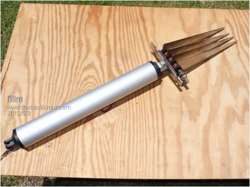

I then sourced some fast acting linear actuators that could extend and retract 200mm in 1.25sec along with controller boards as well as a manual motor controller for testing , the only problem is the actuator voltage was 24V, so would have had to use a 48VDC-24VDc converter which luckily I have a few I picked up a few years back .
After sending down a linear actuator and solid state motor control to Pete he then put together a control board and I started on all the fabrication of the tank and plates etc.
Linear Actuator with S/S Plates mounted
Tank made from 300mm ABS Pipe

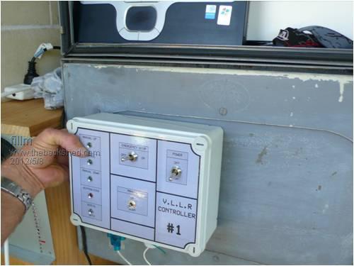

After probably much hair loss and probably a whole lot of cursing the whole system was tested and sent up to me to fit, and I must say as you can see from the pics Pete put together a very professional well finished control box that has all the circuitry which I mounted into the lower electrical box .

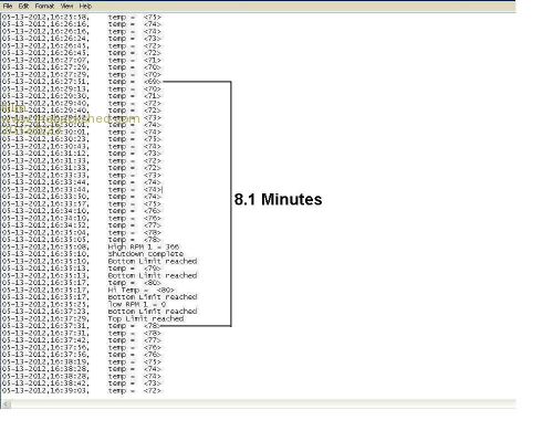

The controller triggers on...
* 1-Voltage Max and min ( Adjustable in Program)
* 2- Rpm - ( if over 340 Rpm Shutdown, if under 300 Rpm Restart ) Adjustable
* 3- Stator Temp ( If Temp over 80DegC Shutdown & If Under 60DegC Restart) Adjustable
* 4- Emergency Shutdown
* 5- Manual over-ride for in and out

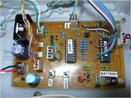

The motor control board is also in the control box but not shown .
The infra red sender unit mounted into the nacell , and is powered
directly from the mill AC .
The 3 infra red senders are mounted in a 100mm pvc
pipe cap and the joiner screws up and holds the ring in
place and also shields the pick up from direct sun .

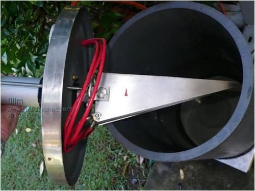

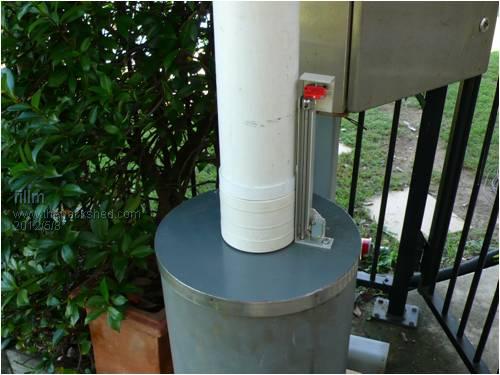

The "VLLR" (Variable Load Liquid Resistor)control box which is now mounted into the box front also has all the manual controlls for Emergency Shutdown / Stop and manual in and out .
The finished unit with the upper and lower limit switches to
tell the controller where the plates are , the actuator also is covered
by some 100mm pvc pipe for weather protection .
I had originally intended to mount the actuator on a S/S tank with the plates being rotated into and out of the fluid with the actuator connected to a suitable sized arm, as I had a heap of the large ABS pipe that was originally used for blades, I decided to go with a
vertical arrangement as shown in the pic, it was simple to build but setting up the limit switches was a little tricky.
I now think that it is a better concept to go back to my original plan of the rotating the plates with a purpose built S/S tank when the new Axial goes up .

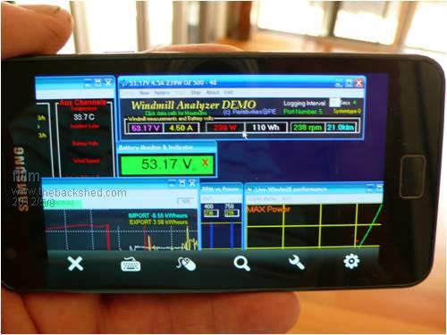

This is also where I think the whole concept moved a bit more hi tech, (well it actually happened way before this point but I will slot it in here.)

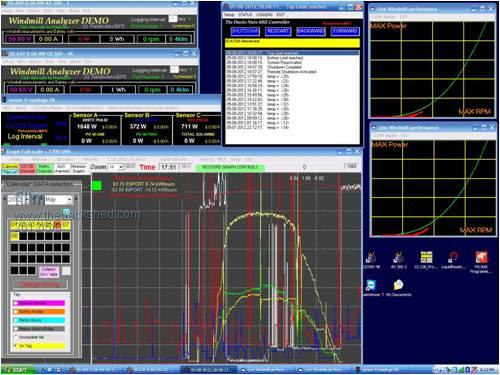

I came across a program called “Team Viewer” and it enables access to computers connected to the net from anywhere, as well as from the latest Iphones and androids , basically I can log on to my Logging Laptop and check on the mills and solar from anywhere in Australia and I would think the world as long as you have internet access or phone service .
We basically thought it would be pretty cool to be able to control and shutdown the mill from thousands of miles away, Gordon put together a VB program with an on screen display and some activation buttons that would enable a shutdown and Restart as well as the ability to manually control the actuator.
The on screen keys send serial data to the controlling circuit, which in turn implements the commands.
The control circuit then sends information back that is displayed in a status window to show the instruction had been activated, it also records to a log record any info of what has been happening with temp and if it has shut down for any reason and the reason that triggered the shutdown.
Its not a really clear screen Dump Pic but thats what happened today and its not much to rave about in the wind side . The VB program can be seen in centre with the stator temps recorded at 2 deg increments during the day and a shutdown and restart at the top of the status screen , so whatever is on that computer can be controlled from a laptop / home computer or mobile phone as shown above
Anyway that’s about it , since installing it I have not had any real wind to rave about, but it has done its job quite a few times with the Grid going down and the solar pushing the battery voltage up past the shut down set point 59.5V, I did have one gusty day when high RPM activated the VLLR. It is also very interesting to watch what is happening with the stator temp, it is surprising how quickly temperature rises once it starts to produce over 500w, this is a bit of an eye opener and quickly jumped from ambient to 55deg a few times on a few 1kW + Bursts.
At present the Temp is set to shut down at 80DegC and now just a waiting game for the winter winds to arrive and give the whole system a good work out and at that time I hope to get some more Video of the system working at protecting the AX300-3 and hopfully this year is not a -4 .

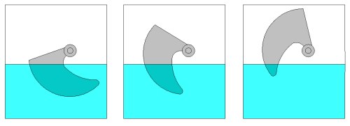

Was thinking about ways to raise and lower the plates, knowing you and Pete did try a stepper motor driven thread but found it to slow. What about this below.
The stepper motor, or maybe a RC servo, is mounted out on the side of the tank, and a direct drive shaft goes throught the tank to a bearing/bush at the other side. The 4 plates are attached to the shaft and shaped as shown. 90 degres of rotation will raise or lower the plates into the liquid, quickly. The picture shows the plates in 3 positions, from full down to nearly full up.
If you have even seen the variable tuning capacitor in a old valve radio you will reconize the plate shape. A small counterweight could be added to balance if needed, and the only real resistance to movement will be wires conneted to the plates. A stepper motor would operate it from one end to the other within a fraction of a second, but I think you could also use a RC servo motor ( hobby, remote control ), the PicAxe chips have the commands to operate RC servo's, but they do jitter a bit.

Yea you are right ,there are a lot of options with plate design and how to control them . I like the plate design you have shown and I can remember those plates in the old valve radios . The only draw back I see is that it increases the size of the tank above the fluid to allow the plate to rotate up and clear which decreases the fluid volume or increases tank size. The same can be said with my present set up as the plates are 300mm long so they need that clearance, but it was an easy option to get it all up and going .
In the next liquid resistor I intend to go with approx 30 x 400mm plates with a bit of a taper at the end . My tank is 500 H x 500 L x 300 W , so allowing about 70mm for the rotating shaft and a bit of clearance between the fluid and the bottom it should give a fair volume of liquid to heat, if required.
To get more load can be easily done by raising the Ph , closing the plate gap or increasing the plate width .

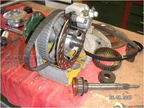

brucedownunder2
Joined: 14/09/2005
Posts: 1548
Posted: 09:19am 09 May 2012
Bad news Phill,,
Remember the silly old fart that suggested a disc brake years ago ?????..
It's still in a plastic box ,, bet you it will prove my point some time soon ...
Don't mean to be rude ,,, but you did put me down on my suggestion!!!
Bruce

For example with 15 amp output, 10 amp could be sunk to the fluid and 5 amp supplied to the battery, maintaining a steady battery voltage, allowing for the battery to be full charged or topped off, as the voltage rise the probes would step in slightly shunting more current to the fluid and maintaining the set voltage.
This made for what jokingly got called "The Ducks Nuts" controller as the principle of liquid resistors acting on the 3 phase AC worked so well and so smooth.
From what i have seen thus far, the system Phill has constructed here is really "The Ducks Nuts" of control methods, but we both agree real world testing will prove this true or false with time, as bench testing can only prove concept and mother nature can pose issues that testing dont account for.
Its a lot of work and depends greatly on electronics for control, so not a project for the light hearted amateur.
The control electronics is split between 2 chips to keep response times fast and smooth.
1 chip controls the actuator and monitors the voltage using 16 bit ADC resolution via I2C.
The second chip monitors all other inputs/outputs from limit switches, rpm, temp, serial data in and out from PC, manual switches and any other function, then controls chip 1 accordingly.
Each function received to chip 1 is acknowledged back to the second chip to ensure the command has been received and executed, chip 2 then sends a text message to the PC to be logged in the records of operations preformed.

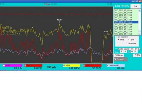

I had a bit of wind about a week ago that tested the "VLLR" liquid resistor control system out a little and also gave a good indication on how quickly AXFX type stators heat up when they are starting to pump out the watts . I would not call it a high wind day but in a period of about 6 min the stator temp went from 70deg up to 80deg with a few gusts at around 35 ~ 40klm . The data log can be be seen below for that period with the shut down for ( high RPM ) coming in at the gust peak and at the same time the High Temp shutdown activated @ 80DegC. Prior to this there were a few peaks of 1500 ~ 1600W, this being well below what this mill has peaked at previously. The Restart can be seen as "Top Limit Reached " as the plates come out of the fluid.
As the whole day text file is too long to fit on a screen dump I can only show sections of it, but for most of the day the temp sat around the 50~60deg in 15 to 20km wind.
The pic below is a screen dump of the same period on the windmill data logging screen which shows the the peaks coming through for the same period on the VLLR status log file and being logged at 10sec intervals which does not capture the actual peaks, the shut down period and then re-start can be seen.
The gusts were definately not sustained , and what I find now with the ability to log what is going on with heat up at the mill head is a real eye opener . As the 80deg Temp set point shutdown has been a trial to see what it actually takes to get to that point and the fact that it really does not take high output for a long time to get to that point.
With cooked stators being one of the most common failures for axial flux type alternators it is little wonder when you see this data . With the heat build up over a prolonged high output period causing the softening of the resins used in the stator combined with the forces trying to bend and move the copper windings, then it can all to quickly add up to a burn out and/or a run away mill as I have experienced 2 times now with this mill when a forced shutdown was required on top of prolonged high wind and output.
All in all the Liquid Resistor Control system did its job in automaticly protecting the mill and smoothly stopping the mill when a set point was reached and held the blades in stall untill it was allowed to restart, the High temp set has now been raised to 95deg and the RPM left as is to see if that will keep the stator temp stable before raising the RPMs . I will also add that through all this the mill was still furling as it should in the gusts and even with the furling set quite soft the stator still heats up fairly quickly.

Thanks and good to see someone from fieldlines come over for a visit , these new android phones and some of the apps are amazing . Nice work on your blade simulator App but I am not sure what program you could add to this system ?
I guess the controlling the mill by a mobile phone would be frouned upon by some but its a bit of fun and who knows what the future holds .

Hi Octvio,
Thanks again for your offer but I would think the program required to do what "Team Viewer" is doing would be quite lengthy and difficult program to write . The Host " logging laptop" can be accessed by anyone with the T/Viewer program on their laptop/mobile phone as long as they have the address and current password . The password can be instantly reset after thay have accessed the computer, as well the owner has an Admin Password to gain access at all times.
The good thing about this is the screen stays live unlike " Remote Desktop " and multipul users can be logged into the host computer, and the computer functions as normal for all to see. The program/app can be set up in minutes without the need for a complicated set proceedure like "RDP"and it works straight away. This has been an invaluable tool when we were first iorning a few bugs out , as both Pete and Gordon could be logged in and able to watch, access picaxe chips and reprogram from thousands of miles away as the need arose.
The "team viewer" program is availabe as a free trial version as long as it not used for comercial purposes, hopfully it stays that way as it is a very expensive program/app to buy.
If you do want to contact me to discuss what you had in mind feel free to drop me an email phillm6@gmail.com .

Just a bit of an update , I had some good wind a few days ago but still not up to what you would call high wind, with gusts coming through at about 35 to 45 klm which puts it into the 10 to 12m/s range where wind turbines should be in the self protection stage .
The control system was at one stage frequently being activated by the high RPM set point of 350 RPM and by the time the plates were fully in and loading the mill the Rpms a few times went through 400Rpm if the mill was comming out of furl at the same time of the wind gust . It was also incredible to see the brute power the GOE222 blade produces as the blades a couple of times powered through for quite a while before going into stall.
The stator temp was another shutdown that came into play , as the outputs were reaching up to the 1500w and peaking at 1850W with the RPM limit the stator temp was easily getting up to 80 to 90degC and when the RPM limit was reached a couple of times while the temp was at these levels the shut down would increase the stator temp by 8 to 10 deg and then go into the "high temp" cool down . As this was around 20min I shortened this by reseting and letting the mill go after a few minutes and by this time the temp each time had droped by 20deg back to the 70.
This made it pretty easy to see how these blade can easily smoke an AXFX mill as I have done twice now by trying to stop it by shorting.
So basicly the whole system had a fairly good work out and I have now increased the temp shut down point to 105deg and left the RPM the same . The more I see of the behaviour of the GOE222 blade the more respect I give it with the power it can develop and what controls are needed to tame it in high wind.
The liquid resistor and controlls did their job. It opens up another way controlling large amounts of power generated with out the need for large relays and to be directly be connected to AC from the mill , how the plates are moved in and out is open to many variations and plate designs like Glenn has drawn on the previous page.
