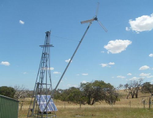

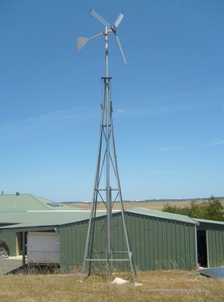

Hi all,
I had an old 4 post windmill tower left over so I decided to use it as tower for the 500watt turbine. Problem was to get the turbine to sit on top of the tower but still be easy to lower to the ground for maintenance or in the case of very strong winds (something we are not short of here).
I had seen Downwind's design and decided to incorporate the hinged pole and swing-over latch at the top into my setup. Guy wires were a severe inconvenience, hence the mill tower.

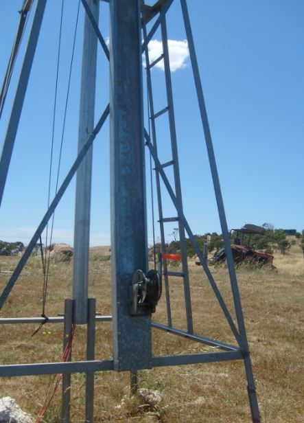

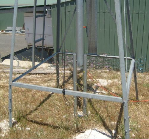

The cross braces on one side of the tower were removed and re-sited to just past the middle of the tower with the top being completely open. A 75mm galv light guage water pipe was hinged at the bottom just above the lower cross brace (left this one in its normal place). This allows the pole and turbine to be lowered to the ground, ending up about 1 metre from the ground.(a nice height for working on).
The pole is winched up and down using a light weight boat winch. At the top is a swing-over latch that combined with the winch, stops the pole from coming down.
The bit I like, is the "no guy wires"

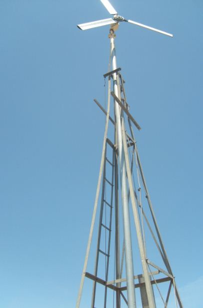

I like your tower idea however I would be putting some extra bracing from the sides that you removed the bracing from. Those to sides out there can easily flex in towards each other or out making it very susceptible to collapsing under load.

[quote=madness]I would be putting some extra bracing from the sides that you removed the bracing from.[/quote]
If you look closely in the third photo, you should see that the bracing that was on the outsides of the tower has been refitted roughly across the middle of the tower in the same direstion that it was. Also, the bottom bracing which is about a metre up from the ground is stil in its original position.
I have been making and installing and using windmill towers for years. You should also notice that the diagonal bracing on the other three sides is still fitted.
It has been through some pretty horrendous gales here and hasn't batted an eyelid.
The windmill head that used to be on the tower had way more wind loading than this little turbine has.
