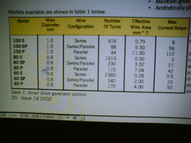

hello to everyone.
I have collected some output data for different F&P versions. - sorry not yet the new rotor

makourain
Joined: 19/04/2006
Location:
Posts: 111
Posted: 08:52am 19 Apr 2007
got this from a friend, dont know if he wants to be named.
