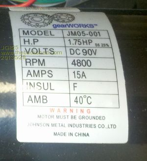

Let me start by saying, I'm a tinkerer, not an engineer.
Two years ago I built a three blade windmill using an old treadmill motor. Here is the spec plate from the motor:
I just mounted the windmill on a ten foot pole a few days ago -- I've been busy
My problem is that I am only getting about 3-4 volts when the wind is blowing around 15 knots. My thinking was that if 4800rpm produces 90V, then if I could achieve ~ 700rpm the unit would be producing around 14V which would be good for charging a 12V battery. Where did I go wrong? Is 700rpm a reasonable expectation with 10-12mph winds?
Does this motor need to be geared?...
The blades are ~ 33" and the unit operates very smoothly.
Also, when I was taking the voltage readings, the the voltmeter kept flashing between the 3-4 volts and 0. I had checked the output of the motor with a variable speed drill when I built the unit, but it has been sitting in a garage for the last two years.

Your problem is the motor , 4800rpm / 90V = 53rpm per 1V , so if you are want to charge a 12V battery then you will need 14 ~ 15 V output so 700 to 800 rpm before you reach charge RPM .
I hope the add said " NOT suitable for a wind generator" .
Gearing is not worth the trouble , I would recommend looking for something in the 70 to 140 rpm range and keep away from the Car Alternator modded PMAs sold a wind gens in the US.

700 rpm is not realistic, and you would need to be down closer to around 100 rpm for cutin to the battery.
The motor is a poor choice for a windmill.
4800 / 90 = 53.3 rpm per 1 volt
so your mill would have been doing around 200+ rpm for the 3-4 volt output.

As others have been saying, you have picked an unsuitable device for your experiments. The basic problem is that your device was designed to operate as a motor with a 90V power supply, and to turn at 4,800 RPM.
To operate as, say, a 90V generator, you would have to turn it even faster - maybe 5,000 rpm, or more.
At a typical direct driven wind generator speed of somewhere less that 500 rpm, you will get less than 9V output, and with the following shortcomings:
The motor stator will be wound with thin wire which will have a high resistance, and hence high losses for operation at much lower than its rated voltage.
The stator winding will have many turns of wire, so its inductance will be high, which will also limit its current output under load.
To further complicate things, the larger the turbine diameter, and hence potential power output, the slower it will turn. More blades will only cause it to turn more slowly. You need to have a look at the many articles available on tip speed ratio.
What you need to produce a useful amount of low voltage power is a low speed low voltage motor or generator - preferably with a permanent magnet field. Note also that low speed devices need to have a significantly larger diameter than your motor to produce useful power effectively at low speeds.
I hope that this encourages you extend your experiments into areas that will give you more worthwhile results.
