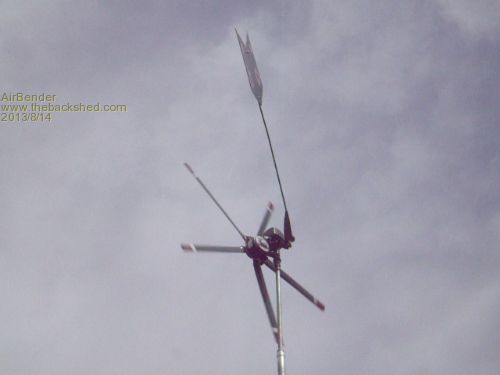

This is the small mill that converted me from vawts to hawts
It only has 500mm long blades and puts out 100w just before it starts furling, while my Vawt with 2m blades is lucky to make 60w in the same winds.
The small hawt has been up for 2 years and given very little trouble.
