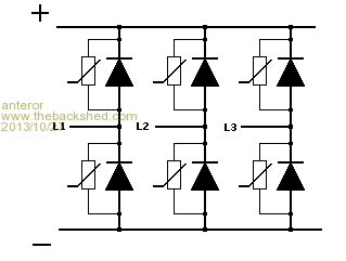

High guys ive had some high winds over here and found my mills new weekspot its the rectifire that turns the ac output into dc mine was two 100 amp brides connected in parallel , I was told that there will always be one that cuts in first and does all the work this is true because one got warm first
anyway long story but they died,I have used an old car alternator for a while but it fried quiet fast.
Any idears?? for those that do not know my mill its 4 meters diameter 24 volt and I see spikes of 180 amps often yes the furling works and it goes back to around 1200 watts but in crazy wind you get spikes like this.
I just want some diodes that will live.

Sounds like you need a bigger "rectifire" or even a Rectifier. If you are seeing spikes of 180 it is possibly going higher than that but it happens to fast for you to see.

As most modules are common anode or common cathode and what you really want for a 3 phase rectifier is the version that has the "D" prefix in the part number as it stands for doubler, and the base plate is connected to anode of one diode and cathode of the other diode (single bridge rectifier style) you would require 1 for each phase.
Personally i would just go for one of these.
http://www.ebay.com.au/itm/AC-1600V-300Amp-Black-Rectangle-P lastic-Case-5-Terminals-Diode-Rectifier-Module-/161044031189 ?pt=AU_B_I_Electrical_Test_Equipment&hash=item257ef8e6d5#ht_ 2176wt_1141
Pete.Edited by Downwind 2013-10-27

I had the same problem, untill I made myself the tree phase rectifier with heavy-duty bolt diodes and they must be installed in big cooling plates and have button thermostats and some fans for extra cooling.
You need two cooling plates and 6 diodes.
(3 units bolt= anode and 3 units bolt= cathode, so the cooling plates are + and - )
Example of 200Amp diode.(You can find them locally from electronic shops also):
http://www.ebay.com/itm/1200V-200A-Recovery-Rectifier-Diode- Stud-Version-ZP200A-New-/400353886144?pt=AU_B_I_Electrical_T est_Equipment&hash=item5d36f37fc0
Here for example 24V fan;
http://www.ebay.com/itm/8025S-24V-Brushless-DC-7-Blade-2-Wir es-Cooling-Fan-80x80x25mm-JT1-/290986983343?pt=UK_Computing_ Case_Fans&hash=item43c02cffaf
When you go over 100Amps, you really need all this.
Here is a diagram of tree phase rectifier.
You do not need those varistors (voltage dependent resistor, VDR), which are connected to the diodes in parallel, when you use heavy duty bolt diodes.
