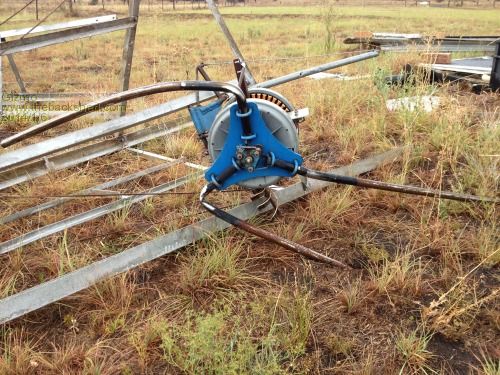

Had a bit of a storm super cell pass through here today, crap flying everywhere. I was in the shed shutting down the power when the storm was at its worse, rain was deafening, only lasted 5 minutes. A few minutes later I was back up at the house and looked out to my windmill. It was gone. Mast still there, no windmill.
Found most of it about 15 meters from the tower, where it crashed into the ground next to a old farm windmill tower.

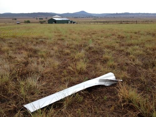

Found 2 blades, one about 50 meters away, in perfect condition. The other about 150 meters away, with a obvious dent from a tower strike.
Cant find the other blade, its not within 200meters of the tower that I can see.
Did a bit of a forensic investigation. All blade shafts show signs of bending back ( paint off front face, where metal stretched ), and one blade shows a tower strike. So I guess a wind gust bent the blades back, one or two impacted the tower, deformed and rotated around the shaft, shearing the rivets and headed into the sky. With a blade or two gone, the thing would have been seriously out of balance and self destructed very quickly. So much so it lifted itself off the top of the tower, breaking a 4mm stainless wire cable ( the furling cable ) in the process. The furling cable shot down the inside of the mast and exited near the cable tie off, none of it was left inside the tower. All blades came off the shafts, despite the number of rivets I had used and the fact I needed a sledge hammer to press them together.
The turbine hub is destroyed, but did stay together. Not one piece of metal is straight, all bolts are stretched and even a few nuts have lost their treads and slipped over their bolts. The F&P shaft is bent, about 5mm out. Front magnet hub broken, both stators are cracked, but should be repairable. Rear hub has a few broken magnets. Tail hinge bent and the tail boom broke in half. Not much left to salvage

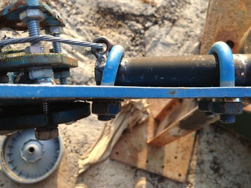

The U bolts held, but all blade shafts had slipped a few mm before things went bang. Considering the abuse this thing has survived in the past, it must have been doing some serious RPM today.
My regret is I didn't make the shafts for this windmill like the one's I've made previously. I prefer to fit a solid steel core into the tube about 500mm. It gives the U bolts something to bite into that wont crush, and strengthens the first 500mm of the blade root, where its under most stress. These blades only had a short core, just past the outer edge of the hub. Its after the core ends that these blade shafts bent, causing the tower strike.
But, this was an extreme event, and maybe something else would have failed.

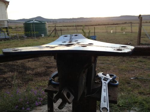

This is the bent turbine hub plate. It was made from 6mm Bisalloy 80, which is about 3 times the strength of regular mild steel. I'll see if I can bend it back into shape with a large sledge hammer, but I have my doubts, so might have to get another one made.

I would be interested to see some pics of the rivet holes in the blades and tubes? For 3 blades to all slip of the tubes at the same time is rare .
In the pic of the blade hub it looks like the all-thread has been striped that holds the blade hub to the back plate
Posted: 04:43pm 06 Jan 2014
Yeah a few of the nuts have torn off threads, in several places. Things have bend and broken that you would not expect to. There's a chunk taken out of the tail fin, which had separated from the rest of it and was a few meters away. The more I look the more it looks like a grenade went off. Wish I had seen it happen.

Yeah Pete I think its critical the first 500mm or so of the blade shaft be solid or thick walled pipe. It was the pipe bending that started the self destruction of my mill. The centrifugal forces had given the U bolts a hard time, but they held, and the mill may have survived if not for the bending pipe. Once he blades hit the tower, its all over. Looking at the blade that struck the tower, I can see how it was deformed by the strike and tore itself off the shaft. The blade opended up from the inside, pulling out the rivets and heading skyward. The rivets are missing from it and its shaft. The other two shafts, and one blade, have the rivets cleanly sheered off, but still in place.

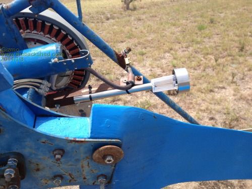

The single stator mill is up and running. Its a 80 series with a staggered stator, a 1X8C and 1X6C.
For a bit of fun I added a light to it. Something I've been thinking of doing for a while, using a 10 watt bulb I could turn on from the ground. But for now I added a little $2 solar garden light
