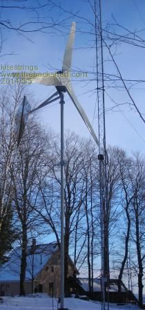

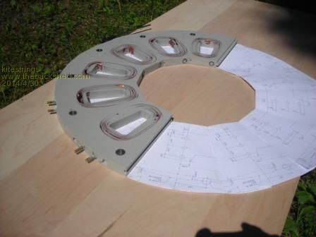

I’ve been wanting to post on this turbine build here for a while. It’s a HA axial WT that we completed near the end of last year. It is up on a ~25’ guyed stub tower right now, as we get to know one another's patterns a bit better. We hope to have it up on a 100’ tower by the end of the summer.
I’ll give a few of the specs and then describe some of things that we did, or did differently, with this one:
Upwind, horizontal axis, direct-drive
3-blade, fixed pitch 15’ rotor
Furling tail governor
Neodymium PM, 16-pole axial-flux, ironless core alternator
~90 RPM cut-in at 58V
Dual full-wave stud mount diode bridge rectifiers
Charging 48V nominal battery bank, via (2) MPPT controllers
RPM gage
Local network connection for system monitoring and configuration
Web-enabled log history
Here are the main departures from some of the more common axial builds:

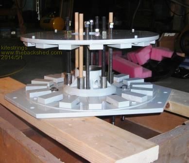

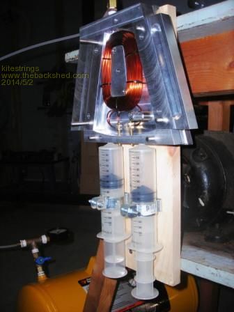

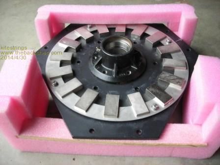

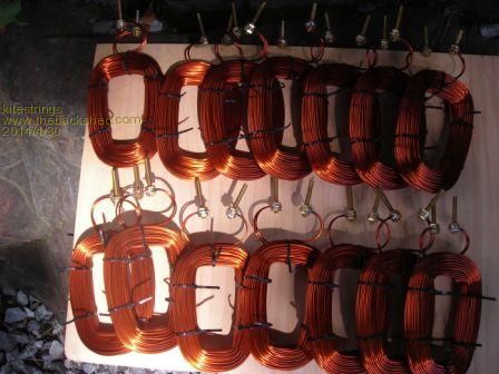

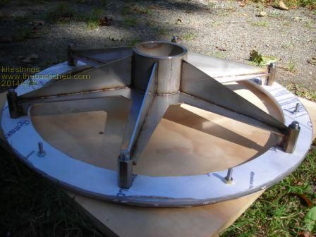

We individually potted stator coils, or sectors using thermally conductive epoxy encapsulant
The stator sectors are fitted using T &G interlocking joints to the neighboring sector.

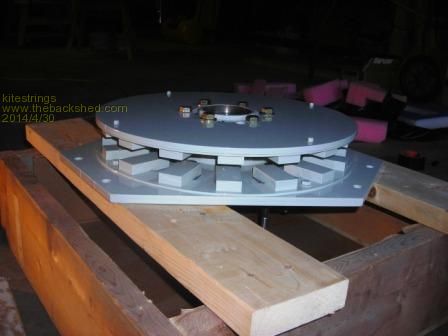

So, the magnet rotors can be assembled on the hub and gapped and then the stator inserted into the alternator.
The coils have open cores for better cooling.
Conceivably the stator could be field-removed, and/or the alternator lowered independent of the yaw-head assembly, tail boom and vane.
The hub plate (hi-strength, A556) is also the upwind magnet rotor.
The stator bracket assembly connects the stator to the spindle using a keyless bushing, so it too could be removed if needed.
More to come...

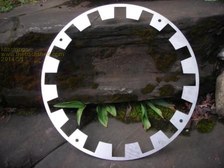

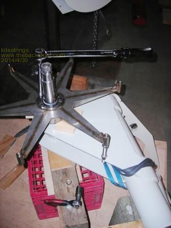

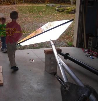

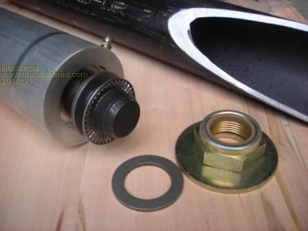

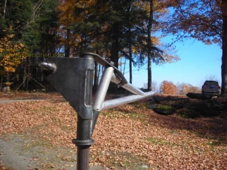

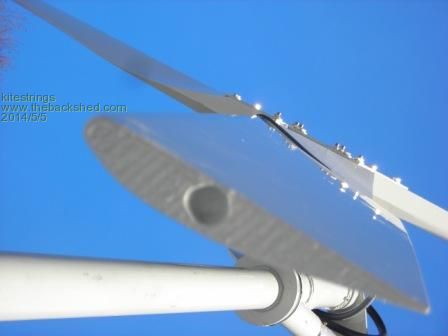

We used CNC cut SS retainer rings to locate and partially secure the magnets
The rotors are gapped using SS spacers or stand-offs off the back of the hub casting instead of all-thread.. Matching shim washers allow for fine tuning the gap spacing.
The tail-boom is aluminum. The inner boom can be adjusted in or out for furling adjustment. The tail-vane was originally SS, but we since have gone to aluminum to reduce the weight.
The tail hinge has graphite/bronze radial bearings and a needle-roller pin thrust bearing
The top of the yaw head assembly is extended past the hinge point to form the stop. here is the boom in the unfurled and furled positions
more soon...

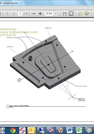

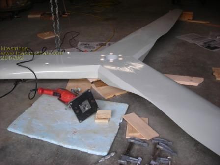

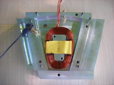

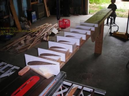

Here is the mold set-up. Breifly, I sprayed the mold with a couple coats of releaser, inserted the coil and bushing, located the terminals in the top of the mold, covered and heated (warmed) all parts. Then I applied a vacuum to the bottom of the mold, while injecting the epoxy into the opposite end. Inverted, topped off, then air cured 24- hours and post cured in an oven.

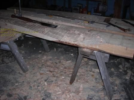

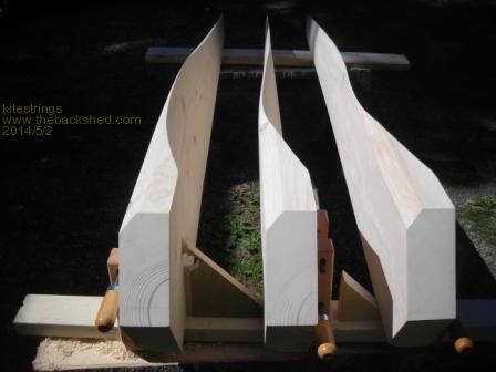

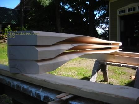

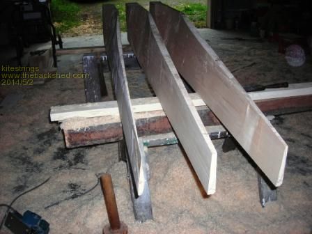

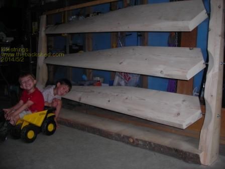

Here are the blades. They were cut from solid blanks of local eastern balsam fir.
Our paint rack

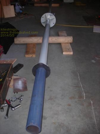

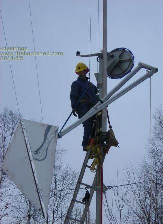

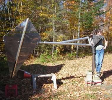

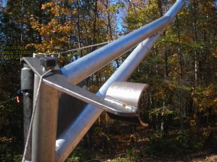

Here's the tail-boom and vane. Mary, my wife kindly lent some ballast before we got the base welded to the test stand. The boom has three positions.

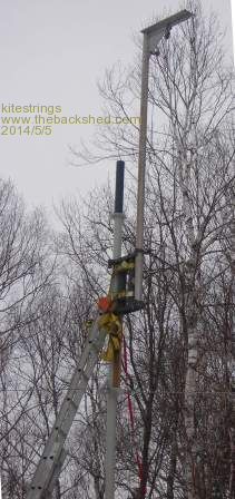

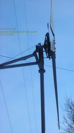

This is the stub tower. There is are matching flanges on the tower and head assembly. We used a metal/graphite thrust washer between them.

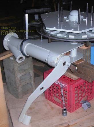

Here's the yaw-head. There are no slip-rings on this machine. The strain relief holds an SO cord down the center. Beside this is a pivoting pulley head for manual furling.
We put it up with a gin pole. I don't know as I've ever had one that I could reach with a ladder.

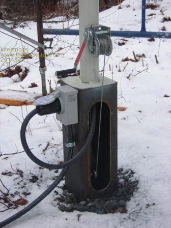

Here's the manual furling winch (vis-à-vis PhillM's preference above). This is really just for manual shut-down - maintenance, icing, forecasted high-wind events.

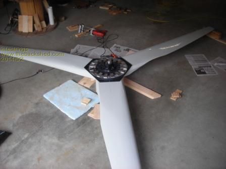

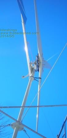

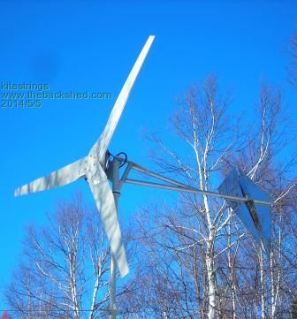

Here's the completed machine except for a weather shroud that I'd planned for the alternator and a spinner/nose cone
You can see the dyneema line that actuates the furling in the next couple of photos. This line runs down the center, then transition to the winch cable at a "sash weight" which just keeps the line taught.

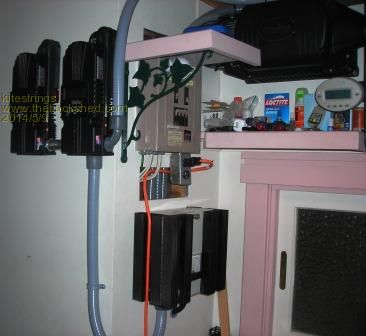

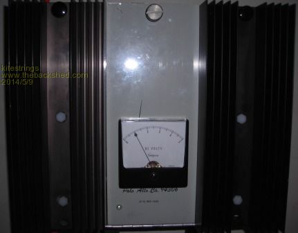

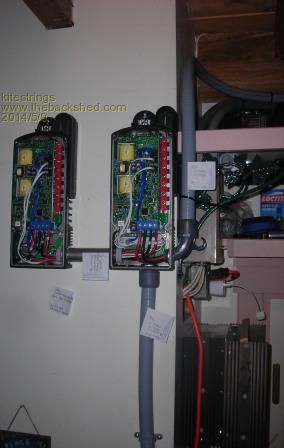

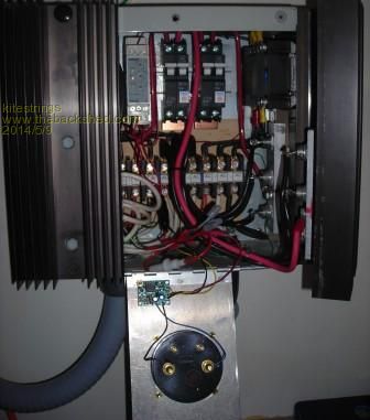

Here's the rectifier box that I built. It has two isolated stud-mount diode bridges rectifiers. I built the box so that the front pair of heat sinks hinge open to the sides to allow access. BTW, I don't live in CA, US, this is just the box shell that I started with.
On the front cover is an RPM gage (0-5V = 0-500 rpm). The small green LED begins to glow when there is anything over 5-10 rpm, and glows brighter as the rpms increase. This enclosure also houses the breakers, hi-limit and dump relays and a hi-limit voltage sensing relay that works independent of the controllers.

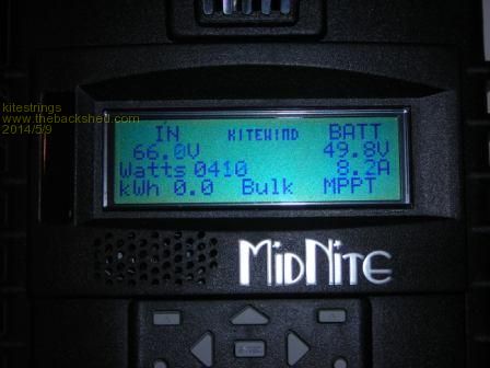

The rectifiers feed into two Midnite Solar Classic MPPT controllers.
Each of the controllers can handle about 2.6 kW. The first one springs to life when the input voltage hits cut-in (~58-59V), the second one wakes up at about 80-85V, but starts to handle any excess at about 104V.

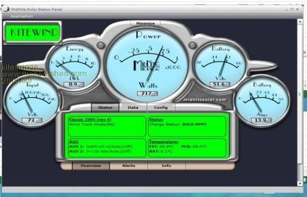

This is the "local app" that allows you to see instantaneous output and make configuration changes. There's also a web hosting site that lets you view log data.
I'm building the resistor load box for it right now. We still have to move it up on the permanent (guyed) tower later this summer. I have to first complete a weather shroud for the alternator and fit-up a proper spinner (to make a truly happy turbine ). That's pretty much our project to date.
