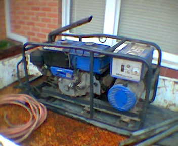

got this last week too, edy6500 diesel, yamaha brand with kubota engine electric start...
$700.00

dwyer
Joined: 19/09/2005
Posts: 575
Posted: 12:43pm 03 Jul 2007
hi grolly
There is nothing wrong with edy6500 diesel, yamaha brand with kubota engine electric start which is well known company around the world and kubota engine is good one and should last long time and change the oil more often however take my advice dont use any car motor oil buy proper diesel oil which has high detergent that design for diesel engine however funny things can use diesel oil on car but cant use car oil on diesel motor
Dwyer The bushman
