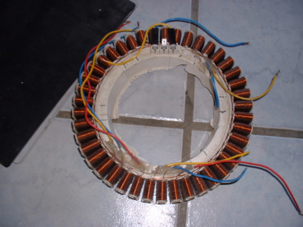

To All ,
As I have almost completed my first mill mechanicaly , I am now getting into the elect side and I am wanting to know does anyone out there run a 48V system ? , or can give me advice on how to reconfigure the stator to achieve this ... Why I am trying to get to 48V is to be able to connect the wind gen through a battery bank into a latronics PVE 1200 Grid tie inverter. The other opt I have thought of is a 24V - 48V convertor but have not heard or seen of such a beast..I have posted pictures of the mill a couple of weeks ago [ my dual stator & seeley ] my aim is to get 48v out of this mill ..... Any suggestions from all the elect gururs out there would be appreciated ....

Trev
Joined: 15/07/2006
Posts: 676
Posted: 10:56am 16 Jul 2007
Hi Phill,
To do the star/delta switching you need to have ac wires down the pole from the delta formation. One end you take power from all the time, and the other end can either take power (delta) or be connected together (star).
It is also possible to series the dc output in low wind and parrallel the dc output in higher wind at the bottom of the tower. Yes you do need to rectify first.
Too many choices hey!!!!!
Here is a pic of the simplest way to make 7 pole delta. There are a few wires missing, but I'm sure you can work it out. You should have a total of 12 wires out. The 2 halves can be parralleled, by phase, reducing the number of wires.
Trev @ drivebynature.com
fillm
Joined: 10/02/2007
Posts: 730
Posted: 11:06am 17 Jul 2007
Hi Trev,
Thanks , I printed of the diag from 6/1/06 and took it home and scratched my head for a while as it was not anything like I remembered about spliting the stator into two halves anyway it shows the same as a 2 pole but said 7 pole ... I sat down with a busted stator and came up with exactly like you have shown . I thought I would go with the whole stator in star or delta and that would give 6 wires out for one stator and 12 for two if bringing AC down the pole, and switching from star to delta at the base. Whats your thoughts on two stators 7 pole delta into 2 x 3phase bridge recs that are have the DC terminals in + - < joined > + - to get the amps up at 48V at lower RPM for big blades ?
