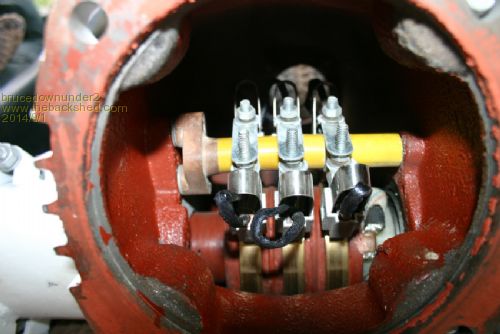

OK Pete ,
The Exmork has a perfect straight passage ,small but unobstructed vertically down through the slip-ring assembly . I've done my homework on that.
Control cable could be easily fed down throught this passage WITH a rotating swivel incorporated for either a stainless steel multicore pull wire to the ground OR a swivel connector for an electrical cable .
Weight , bugger all , considering the Exmork head and other stuff weighs in at 40-50 KG, whats another 2 KG ?

Can't sleep ,, anyhow , this is a picture of the Exmork slip ring assembly while I was retrofitting it with brass and stainless steel hardware-the factory stuff was allready rusty during shipping!!.
As you can see ,the brass slip-ring assembly is around 30-35mm dia, this is perfectly central ,of course. So, getting a cable ,steel or copper down inside there is no problem , just enclose it in a 8mm brass tube ,so the other cables don't rub on it.
