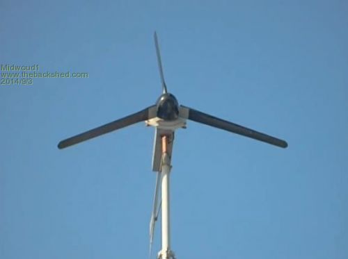

https://www.youtube.com/watch?v=MRVGYVrgsdc Bruce.
I have a succesful pitch contolled windgenerator design.
Working good 3 years.
https://www.youtube.com/watch?v=9jaz3soqXLo
Rgds. Midwoud1 .

Hi Bruce.
Did you build a fly-weight governer?
The complete Active Pitchcontrol design is on Otherpower.
Unfortunatly I lost most of the YouTube videos by a mistake I made.
Will be recovered step by step. Click midwoud1 on YouTube search box.
http://www.fieldlines.com/index.php/topic,145925.0.html?PHPS ESSID=ed13e6d46600cbe9330f239de089f161
Rgds. Frans.Edited by Midwoud1 2014-09-05

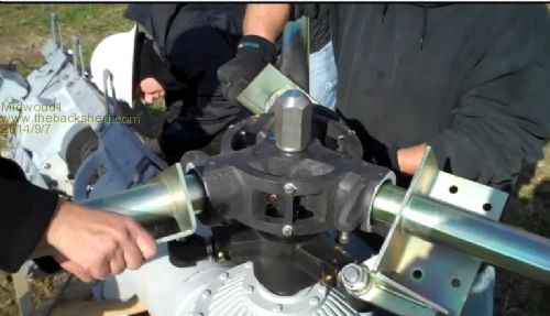

https://www.youtube.com/watch?v=B7gndP6mgTU
Jacobs hub
A good and solid system to sychronize the blades.
Still a passive pitch and not storm proof.
Edited by Midwoud1 2014-09-08

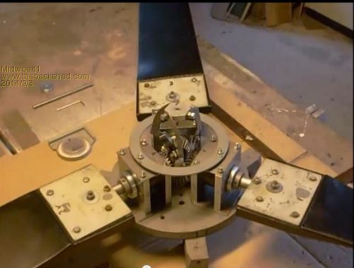

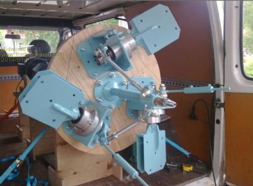

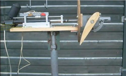

As some of you probably know I am in the process of building a mill. At the moment I am up to the tail section which is a bit of a dark area for me. Ive been following midwoulds active pitch control for some time now(think it first popped up some years back ) and I gotta say Im fascinated by the idea. Watched your youtube fliks and would like to know more about the hub. What is the purpose of the 3 gears. dosent look like they are meshing with any others. Would it be possible to control a head like yours with some sort of spinning governor and return springs ect.? Im open for suggestions as I think there are more on the forum who are also interested. Bruce, do you have that drawing of the 3x cam operated head? Curious to see how it works.
Marcus
Midwoud1
Joined: 25/12/2012
Posts: 23
Posted: 02:14am 10 Sep 2014
GP.
Actually there is a 4 gear . A sunwheel and 3 satellite wheels.
The sunwheel is free running on an extension nylon shaft in line with the mainshaft at the hubfront .
The satellite wheels connected to the blade root shafts hook into the sunwheel.
This is necessary the synchronize the blades.
A spider linkage makes the blades move feather and unfeather.
A push - pull rod from the spider through the hollow mainshaft to the actuator.
That makes it an active pitch system.
I have another system without gearwheels.
A PVC tube with key-holes and a moving plug with 3 studs through the key-holes.
The linkage connected to the blades.
Blades move by a push-pull rod and actuator.
Passive pitch-control.
A spin governer with flyweights and springload like Janne made (Fieldlines)
http://www.youtube.com/watch?v=rUcxmbLfu_U
Rgds Frans (midwoud1)

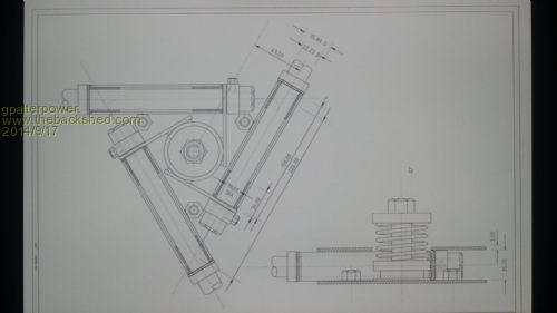

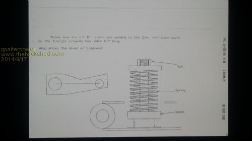

I received these drawings from a friend maybe 20 years back - I thank him and hope he does not mind me posting them here.2014-09-11_210147_bruce1.pdf
2014-09-11_210212_bruce2.pdf
I hope someone can change these pdf files to a drawing , I can't , but maybe you can tell me how in a step by step proceedure,thanks
Bruce

Posted: 12:04am 12 Sep 2014
Hi Bruce,
Sorry to say, the PDF's have been "rasterised" prior to or as part of the conversion to PDF. That is, all the elements, lines, text etc. have been converted to a raster image. While it may be possible to re-construct, it would involve taking the PDF into a program like Adobe Illustrator then "tracing" the lines, text etc. A big job!
Sorry I can't think of any way to assist.
Cheers,
Doug.
brucedownunder2
Joined: 14/09/2005
Posts: 1548
Posted: 10:21am 12 Sep 2014
Thank You ,Doug .
My friend ,a drafting man, drew those drawings for me. Many years back .
The principal is that the 3 shafts turn in hard plastic sleeves,similar to axle pin bushes. There is a cam welded to each and the blades can turn somewhat ,causing the cams to lift the bobbin at the base ,against a strong spring,adjustable,.
When the wind becomes less forcefull, the spring action returns the blades to the original pitch..
Fairly straightforward to fabricate.
One day I'll have a go .
Bruce

Posted: 02:59am 17 Sep 2014
Hi Bruce ,
Hope this helps
Got to open files on my phone.
Regards GP

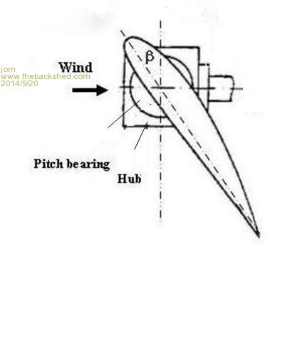

Posted: 10:15am 20 Sep 2014
Every day homebuilders like Midwoud deliver us the evidence that also on small turbines active pitch control is the way to a safe well controlled machine.
What do you mean complex?

Posted: 10:37am 20 Sep 2014
First, thanks to Gpalterpower..(where do you guys get these names,lol.)
Complex, Gee Klaus, there are only 4 moving parts. The spring could be a tappet spring for example.
The rest of the fabrication is standard steel plate , 3X pieces of steel bar,3 common trailer axle bushes..
Me, I'm slowing down fast ,these days ,not the hypo active idiot I used to be.
But, I'll give it a shot ,when I recover.
Bruce
