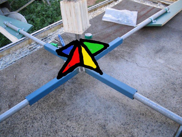

Well Dennis and I were busy early this evening quickly making some curved ply blades from some gear Dennis has bought. I've got 4 blades to setup on my folding tower next to my shed. As I was late getting home the pic's will be put on here tomorrow but these new type of blades do look promising. At the moment it's blowing a gale but whats the bet when the new blades go up murphy will pay a visit.

Hiya Guy's,
Well a busy day and i finally got those blades up in the air. Heres a link to the pic's
Dennis's Blades
The angle the tip needs to be set is the magicial 3 degrees and this was easy to do as I have a snapon angle guage and I also used a laser to get the tips all set so they equal. What surprised me is when I went to balance them they were perfect and I didnt need to do a thing. . Now for the mounting Dennis suggested to use an old saw blade and weld the spline to it. I tried that first and found the saw blade warped badly, so scratching around my shed I found some RHS that fittied the gal pipe to a tee. So I fabricated the base and just welded on the spline, too easy.
As I had some wind around and Murphy took a sickie when I hooked a dvm to check the voltage it was showing 21 volts open circuit.
Tomorrow I'll hookup the 200 amp guage and 70 volt analogue guage for voltage and hopefully it will be windy so I can do some tests.
As always it will take time to test these blades so time for me to get that rpm pic project finished and a few other pic projects and truly test these blades out and give an honest opnion on them.
thats all for now
Cheers Bryan

Bryan, you must enforce like this (I think ...)

Eh mate I took down the blades yesterday and checked the angles hadn't moved then put a tek screw in each of the top saddles. That will stop them from flying off. But the first law of wind gennies always comes true bloody murphy pays a visit and yes he did turn up as soon as the tower went back up. The f&p currently on there is a 80 sp rewound as per glenn's article in the silly chip mag and is paritially decogged. When I get time I'll wire up a 100 series and throw that on. But without any wind around it's a bit hard to do some tests.

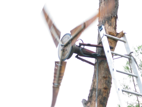

Hi guys one thing I have found very usefull for hub construction is automatic transmission flex plates. I have used a few ford ones, weld a shock absorber washer into the center and it fits the f&p shaft. They are nice and strong and dont flex if you leave the ring gear on. The other advantage is they have holes in the correct places to mount 3 blades.
cheers Robert

Posted: 01:04am 14 Aug 2007
Vasi here is one of my very early ones using 200 liter drum segments for blades. It went quite well but the blades need stiffening. cheers Robert

Posts: 1697
Posted: 01:09am 14 Aug 2007
Thank you for pic, is also good for Lenz turbine.
