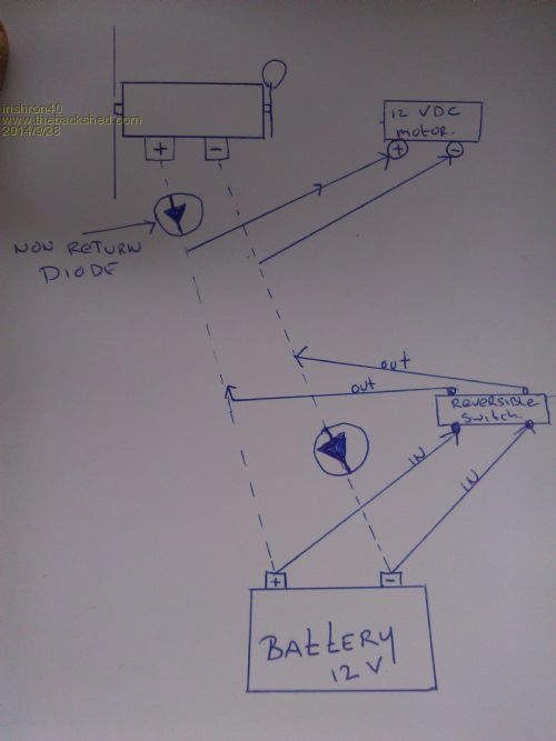

hi.I have a 2 core cable coming down from my 12 volt turbine to the battery.I need to know how I can use those same cables to individualy power my brake motor.Can't figure out which way to use the diodes to stop turbine powering brake motor.thank you.
Posted: 10:34pm 28 Sep 2014
Wont work, you need to get at least one more wire up to the windmill. 3 wires, a common, one from the generator, and the other to the motor, which can be reversed with a bit of clever stuff. Do you know any auto electricians?

I had that figured out have a 3 core cable in place.brake system made from disc and caliper.justctryongvto find out what motor I need to pull calipervcable.thx
