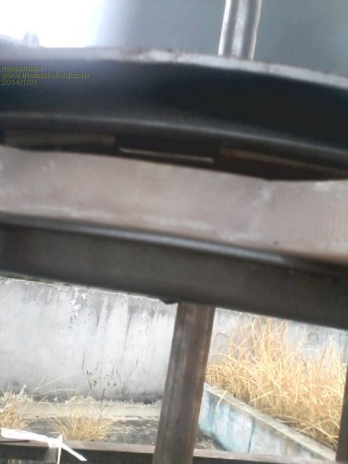

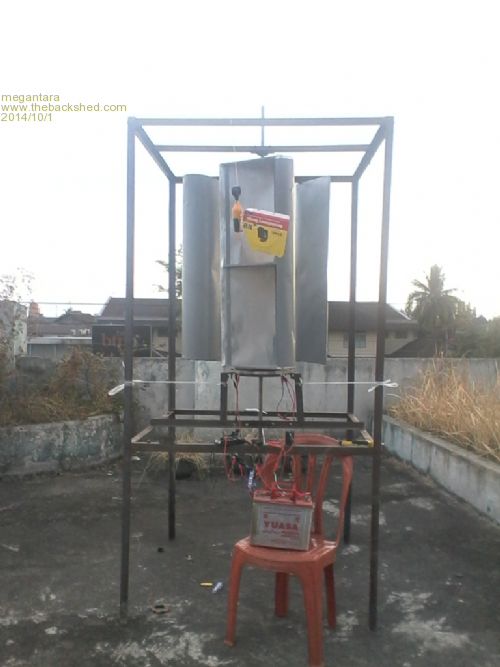

I used fiberglass resin for stator, and the result indeed not good, got some crack when its done. It costs around US$ 2 a liter, compared to $25 epoxy resin (resin+hardener). But i'm thinking to use epoxy once i get the best configuration for my need.
took some vids afternoon
charging 4v flashlight battery
http://youtu.be/RXaU_EWZJ6E
with anemometer, 1-3m/s wind
http://youtu.be/AzQVzKvRLBQ
stator, rotor, and pan
http://youtu.be/9uMcHMrPvOY
took just now
http://youtu.be/AMfbBhyE4eA
sorry... was using phone camera to take the those
Edit:
The frame was shaking quite awful in 4+ m/s wind, and the orange thingy hanging on the frame is anemometer tied to a string with tails behind. Crude, but that's the only thing i have lying around before taking pic/vid.
thank you for your feedbacks, i'm gonna see what can be done with this while saving to buy new set of magnet. Hopefully i can get them by next month. For now i'll research more, and review the things i did wrong in my 1st attempt. This project was money well spent... much better than spending it on bar or gadgets i wont use fully (like iphone or ipad, lol).

Posted: 10:41am 01 Oct 2014
i 've built close to a dozen alternators and never had a problem with polyester resin as long as you let it cure slowly .
it's not suitable for bedding mag rotors 'cause it shrinks .
your mill looks good .
is it balanced? as in, turn it side ways and see if it favors one wing over another.
