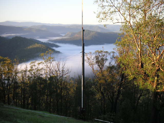

Hello Guys,,   I thought of getting a good Known section (either build it or get someone to send their recovered broken one), then off to the surfboard builder and get him to build a mould . My friend is one of these guys, he suggested it would be not very expensive ,especially if you could sell a few to recover costs--
I'm importing a set of "Art" blades from usa, the 3 blades plus the hub is around 250 bucks -they are fibreglass with strengthers in them -I'll tell you what they are like when they arrive.
Bruce -- tower is at 42 feet -pivots,raise and lowerable in under 1 minute with my big electric winch-solid as .
