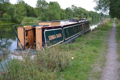

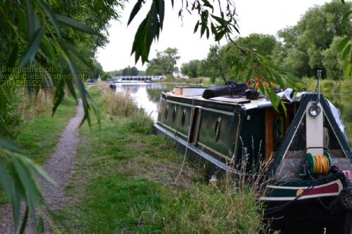

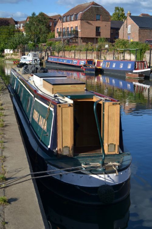

Here art pictures as promised of "Simba Dada"

She's a nice looking boat Bernie
Posted: 12:12am 23 Oct 2015
  Gizmo said   She's a nice looking boat Bernie
Agree with Gizmo, nice looking boat indeed.
But the method of steering her - standing up at the aft end - must be very tiring on long stretches or in bad weather. Does you boat have a forward inside steering position?

Thanks Gizmo & Tinker , we are pleased with her.
They have no forward steering position , they are traditionally steered from the stern. This style of boat is a modern interpretation of a traditional cargo carrying barge - they had a very small " Boatmans cabin" only extending forward about ten feet. Forward of this was an open hold for the load which was sheeted over with tarps. During the 1960/1970's after the demise of the canal system for commercial transport , it has been gradually restored and is now used by leisure boaters and folks such as ourselves whom live aboard.
I usually sit on the roof beside the open hatch to steer in sunny weather , but am thinking of fitting a shelter like this one :-
