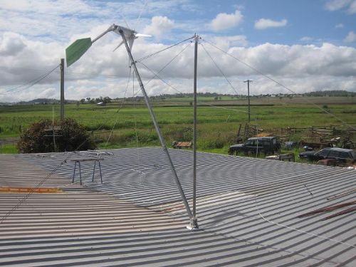

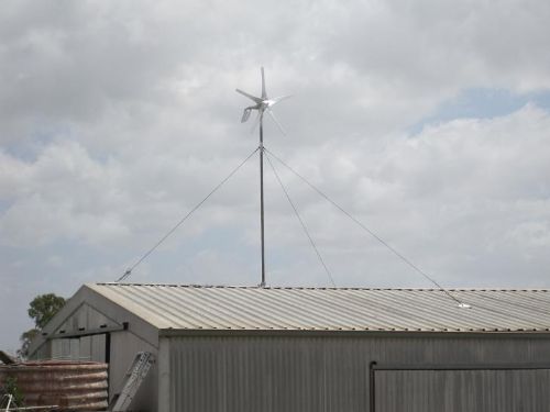

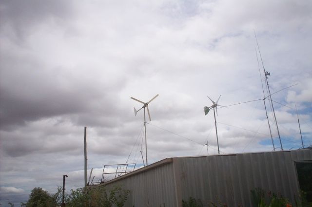

Standing Big China
Ready to go
When you are half way, You are neither up nor down.
Up, up and away.

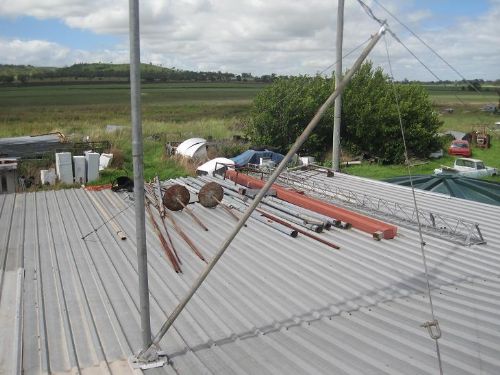

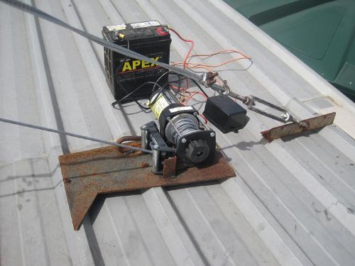

Skinny Jim
Radio controlled push button muscle. (1500kg ATV winch)
The only job I can do standing back with my hands in my pockets.
When I first stood this Genny, my mate and I heaved it up.
It got to a point where it was too heavy to go back down so we struggled on, denting the roof pretty bad.
There had to be a better (easier) way.
Note - The angle iron brackets are connected to a bolt welded to the trusses below.

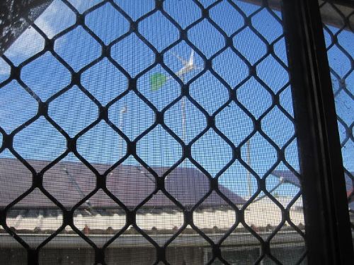

How do you go with turbine noise being transfered into the house? i would expect it to drive you crazy over time.
Sometimes it just works
rustyrod
Joined: 08/11/2014
Posts: 121
Posted: 04:39pm 05 Mar 2015

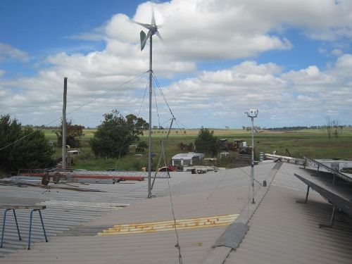

Big China is on the workshop roof beside the house and you would not know it was there until the sun flashes in off the tail.
(Like a speed camera, flash) Some what disconcerting.
In the workshop it is quieter than the cars on the road out-front.
Yes I can hear it and sometimes it sounds like some male talking as they wander in.

A few weeks ago a stranger looking for a way around roadworks using a GPS came down the road which is marked as a through road but is in reality a dead end, saw the wind gennys and lobbed in. He opened the conversation with “Do those wind generators work?”
“Well, yes they do” I replied
“I have one like that one, I think it used to work but it doesn’t any more. Anyhow I pulled the shed down and the generator too, It's yours if you want it”
“Well thank you, How much and Where do you live?”
“It's free, Never mind where I live. I'll drop it off next time I am around here”
And, he was gone.

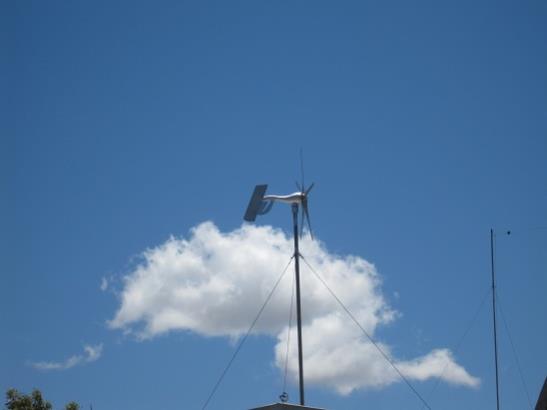

10 days and he was back with the generator still on the mast sticking 15 feet out the back of a box trailer. (No warning flag) Tied in with baling twine. The guy wires were all tangled up with the blades on the floor.
“Here it is, Couldn't find the tail, I hope it works for you. Here is the control box”
We unloaded it “Thanks” and he was gone again.
By the way, the control box was the same as mine. Some coincidence?
I wonder if he will come by one day to see if I put it up?

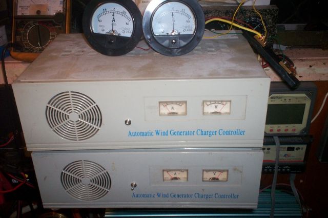

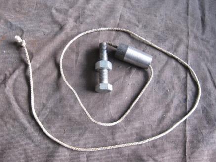

I eventually took the cover off the generator and discovered the wires were twisted together and shorting.
I fitted a slip ring assembly.
I injected gear oil supplement into all the bearings.
Then I noticed only the red and black wires seemed to have been used with the green cut back short, so possibly was only operating on one phase.
On to the controller :- First the voltage regulator and the capacitor near it had exploded !
Second the dump relay had 2 of it's contacts shorted to be in “Dump mode”
Some adjustment with a big screwdriver and it was working again.
I suspect it had been abandon with no battery connected and the voltage had run away.
I fitted a SPDT manual switch for the dump relay.
Up position is to a “Gizmo design” voltage controller, and down is manually locked on to the internal dump.
Next I wired in 6 diodes and a 10uf capacitor to the volt meter so it measures the generator voltage instead of the battery voltage.

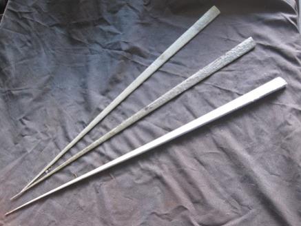

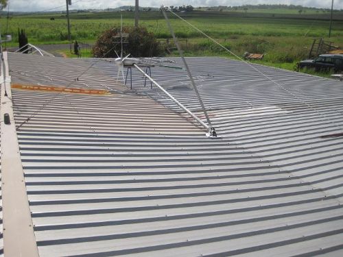

I made a new tail arm and used the vane off the other unit.
I modified the base mount to suit my roof, sorted and extended the guy wires, made anchor points, welded bolts to the trusses under the roof, moved the winch assembly over then, up, up and away.
Easy to say but took about 4 or 5 days all together over a few weeks.

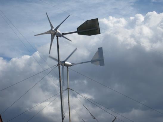

I stayed with the Chinese blades in unmodified condition. One blade seems to “swish” otherwise it is quiet.
There is very little difference in the generating ability of the two units, excepting the Chinese blades start turning in a much lighter wind although not actually generating. (wearing out the bearings)
The inbuilt ammeters are unreliable and no where near calibrated the same!
I could use another of these controllers.
Perhaps you have one lurking in your “Back Shed” you do not require any-more that you might part with. I would of course pay postage. Please PM me with costs etc.
Thanks, rustyrod

After watching Big China for more than a year and watching the new China for a couple of weeks they appear to be much the same
I will quote what goes into the 24 volt battery bank
Starting with wind speed verses amps
Both China at 17 kph have reached 24 volts, no charging
At 19 kph the amp meters are flickering
At 21 kph the two China are making around 3 amps each
and the GIGU is flicking it's amp meter
At 25 kph the two China are up to 5 amps each and GIGU is 3 amps
At 30 kph the two China are at around 10 amps each and so is GIGU
Now the China with the standard blades is starting to furl
At 35 kph the standard blade China is furled and making 5 amps but the one with the American 5 blades is making 20 amps and starting to furl
At 35 kph GIGU is making that HORRIBLE truck brake noise, which I now know is an out of balance causing the blades to warp into a multi sine wave along their length. This varies from 3 waves to 5 or more. (Just Don't look)
It is making around 15 amps in this condition
At 40 plus kph both the China are furled and thrashing about and GIGU, well I am totally ignoring it, I don't want to know what is going on there !
At gusting 100 kph wind I am not looking outside, hiding and looking wide eyed at my wife who is very quiet. No, we can't hear the gennys !
The Air-X 12volt needs 23 Kph to start to lift it's ammeter
At 30 kph the internal voltage protection starts to shut it down and start up again
In between cycles the ammeter is jammed way past the 10 amp mark
I believe it will do better when I bring it down and reset the cut out voltage a little higher
And a larger range ammeter ! Maybe 2 more blades for better low wind starting or small goe222s
Remember these amps are into the batteries not into a dump load or short circuit
I would average each China is making 3 amps per hour per year
There for the answer is :- 3amp x 24hr x 365d = 26280 amps per year / 24 volts = 1095watts or about 1 kilo watt per year per Genny

  rustyrod said   I ordered some of the meters
I got the first China mill when they were all the rage years ago. By the time I got around to put it up the bearings were noisy immediately.
I think the Chinas are OK, I wish I could furl them. I have imagineered a furling cable, although I never seem to have the time to install it
I have GOT to do something with GIGU, it is starting to get to me
Next year! wait it IS next year already
I also have some of Phill's blades for a 32 volt Dunlite. I am still reconstructing the tower

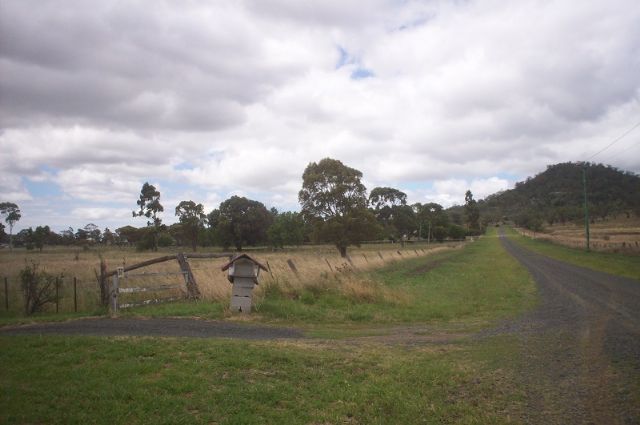

I live down here
at the end of this road, I think the wind gets deflected by this extinct volcano ( I hope it stays that way) and channeled into this valley. See the lean on the trees, even the fence !
I have a few F&P all half constructed, one day I may get one done. I have a spare set of China blades and another set of American blades. It will make for an interesting comparison
As soon as I saw that photo I thought that looks like the area where I grew up and looking at your profile confirmed it. At a guess looking at the trees you were facing north when you took the photo.
I used to have a 1500W Dunlite on a 24M tower just north of Toowoomba on the edge of the range. However, there was way too much turbulence there for it to work effectively, it would just get going and then the whole head would do a 360 or 2 and lose it's momentum and then repeat the whole process. It flogged out the rollers in the governor several times due to this.
The area where you are is completely different terrain so you should not have the same problem.Edited by Madness 2017-01-08
rustyrod
Joined: 08/11/2014
Posts: 121
Posted: 01:36pm 07 Jan 2017
Madness you are correct I was facing north, I left the rest of the mountain out of the pic as it is so recognizable.
The wind is a little turbulent, as these gennys are not very high.
I "jest" about the fence leaning from the wind. Dumb council graded a bank along the side of the road and the dirt is slowly pushing the fence over. I suppose they will realize their mistake and come back and fix it.
I wish I could get hot something from under there for geothermal power. I would need a very long hole now to get to the hot stuff.
There would have been plenty of hot water here a few million years ago
Actually no lava actually came out. It rose up and fell back 3 times then went cold.
There are many hills and humps around here where lava rose under the surface but never came through
The wind has been roaring through for the last few days. Eventually it gives one "bad hair days" and sometimes I think "enough already" as I can't do anything like spray weeds, windmill repairs or much to the gennys, even on the roof is uncomfortable and the bees sure don't appreciate having their lid lifted. They well and truly tell me to "buzz off"
The batteries are all over full so probably will go to "dump" today or maybe I should drag some leads across the kitchen floor and plug the frig and freezer in ?
I must do an up date on the solar hot water ongoings soon.

Hi All,
The wind here has been relentless of late
Both tails furled (camera stopped the blades)
I noticed the second china genny spinning at high speed and also making a winging sound
I tested and found one wire was open circuit, therefore only one phase was now working
I let it down and deduced the slip ring assembly was faulty
I should not have been lazy and fitted a home made set in the first place
I bought one similar to
I now made up an assembly with rings and brushes from an alternator.

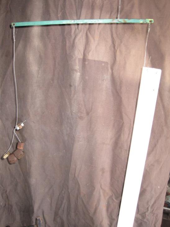

While it was down I modified the blades by cutting 25mm at the tip tapered towards the inner end.
I shaped and sanded the blades, then using a precision balance scale adjusted each blade to equal weight.
Then again using the balance adjusted each tip end to be equal weight also.
I then made a tapered shaft to suspend the hub with the blades attached.
I could not understand why one blade required a ½ inch nut almost to the tip for a balance.
I had measured the tip to tip distances, there were slight differences
Many frustrating hours later after checking and rechecking I realised the blades were not sitting neatly into the hub, also the mounting holes were not equal distance from the tips.
I cut off the inner end and reseated the blades with only one bolt each, I'll be … It almost balanced.
Hours later I discovered just one small tap sideways on a blade would throw the balance in another direction.
Finally I was able to drill new holes and bolt it all together, there was about 20 mm difference at the tips to being perfectly level.
I then re-glassed and painted the blades, they only needed a little sanding adjustment to balance again.
I enlarged the tail which had the side effect advantage of balancing the unit on the mast bearings
It is very quiet now and does not shake the shed any-more
I believe the time involved has nearly doubled the output of this genny
Time to tackle more blades.
