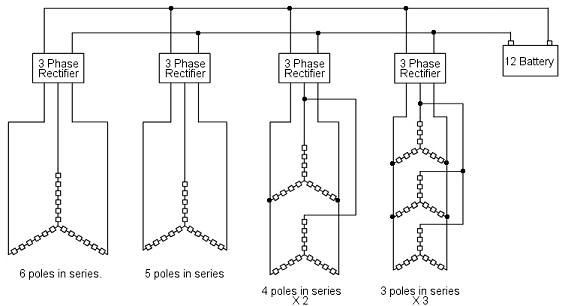

I'm planning to put up a dual stator windmill this weekend, and was contemplating how to configure the stators.
I was going to connect both stators the same way, both as 7 poles in series, 3 phase, 80 series wire. This would give a low cut in speed. Then I though it would be better to configure the windings into different coil counts, ie one series of 6 poles, another of 5 poles, etc.
After looking at a few options, I've come up with the following. I have two stators, each with 14 poles per phase. As the windmill speeds up I want the strings of coils to cut in at different speeds, remembering at the lowest speed there is less power so I want to draw less power from the mill, and at higher speed there is more power so I can increase the load.
The lowest speed cut in will be a string of 6 poles, this should supply a couple of amps under 100 RPM. Then as the windmill speeds up, if the turbine is making the power to overcome the 6 string load, a string of 5 poles will start to make power as it reaches battery voltage. After that I have two strings of 4 poles in parallel, starting to make some good watts now and the wind has picked up. Lastly there are three strings of 3 poles, for max power in very strong winds.
Each of the 4 different configurations will need its own 3 phase rectifier. So I end up with 4 power sources each reaching cut in speed at different RPM's.
This is a non linear load, as the wind increases the load increases exponentially, sort of thing.
What do you think? I know the Air-X windmills use two windings of different coil counts, one for low speed and one for high speed, so I think it should work.

Hi Vasi.
No switching, just a simple case of different cut in speeds.
The outputs of the four brigde rectifiers are all connected in parallel. In light winds only the 6 and possibly the 5 pole groups are generating enough voltage to provide a charging current, as the wind picks up the other groups come online as their voltages rise.
What it means is that instead of a single RPM = Charging Voltage, I have 4 different RPM's to reach charging voltage.

But the 6 poles in series continues to generate and can be to much voltage? If is not too big, the battery is not in danger, but then, 3x3poles poles don't generate enough volts. I think ...Edited by vasi 2007-10-05
Elvish name: Mablung Miriel
Beyound Arduino Lang
Posts: 5198
Posted: 08:50am 04 Oct 2007
Yes thats right, but the 6 poles can only make 1/3 the amps of the 3 X 3 poles. Each pole of the 6 pole will be working harder as the windmill speeds up, but its own internal resistance wont let it exceed the wire capability, ie, it wont burn out. A single coil in a 80 series is only good for a few amps, its when we parallel them up we get the high currents.
The voltage wont go much above battery voltage because the relatively high resistance of the 6 poles in series cant compete agains the low internal resistance of a battery.
The F&P's are air cooled and I've never heard of one suffering damage from overload, tough little buggers. Good thing about a windmill is the faster the wind the harder the coils works, but because the wind is faster its getting better cooling around the coils.
All fun stuff.

Seems like a good idea Glenn.
It steps the loading which is like MPPT.
I have gone down a different track. Vasi's suggestion is what I have been working on for the last 6 months. I have gone a little bit more in that I am using dual x 7 phase F&P's. This then gives me gens in series and parallel as well as Star and Delta making a total of 5 configurations. This will provide from HiVolts for low cut in to All In Parallel for HiAmps. I have been toying with using one gen only to reduce load at startup as your line of thinking has suggested but I'll wait to see performance figures of test run first. (only PICAXE programming to step into that extra setting.)
I don't think you'll be utilizing the full potential of all coils all the time. Isn't that against the RULES???

Glenn,
How are you going to space the arrangements on both stators? I can't see any balanced arrangement there, but maybe you have a trick up your sleeve?
I am also doing the exercise bike thingie at the moment so am keen to try 2 of your four. Thinking your 6 and 4 x 2 as the alternative to 7 x 2 (cutout switch on one bank of 7).

Hi Glen
I feel you are on to a very practical arrangement. The properties of the Fp is that the 6 poles will generate current to a value that is about 200 ampturns then allow more speed to bring in the 5 poles. The six poles will still produce their current but will no be added to by the 5poles.Wereas if you only had 6 poles the mill would start its run away as more input power is applied.
Note it is the ampturns in stator that oppose the flux in rotor that limits current in fp machines when these are equal we have no more flux.

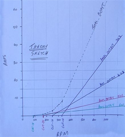

John,
Cutting away the unused half and getting less cogging is a plus. On the other hand, an exercycle needs to be able to have the load variable for a given rpm.
It was an earlier description of your cycle that gave me the idea of switching in or out a heavier load.
With Glenn's I could run 6 in series then switch in parallel an extra 4 in series, then another 4 for a short burst.
Here's how I see Glenn's assorted coil arrangement's performance:
I see it's key features being that it's output power is a closer match to the winds power (velocity^3) than a single linear generator. Also that it needs no external control.
Unfortunately this once again brings me back to the point of prop selection being a compromise.

2MPPT controller would definatly be a plus. It would be best to aim for the highest possible input voltage and step it down. and the use of DC is necessary because of the high frequency AC. The main limitation of FP is the definate current limit when the stator Ampturns approach equal to the Rotor Ampturns. Usuing a high voltage DC would allow less current / coil and more power. also the windmill can be sited further from the batteries.
By the way Gill your graphs would show a flaterning off as this point is approached 200 ampturns is my experiance ie if 80 series has 60 turns per coil max current any series connectin 200/60 = 3.3amps in glens case The 6 branch would stop 3.3 amps then 5 branch would start adding its 3.3 amps as mill speeds up then thnext branch 2// would add 6.6 then 3// would 9.9 amps atotal possible output 19.8 amps.
