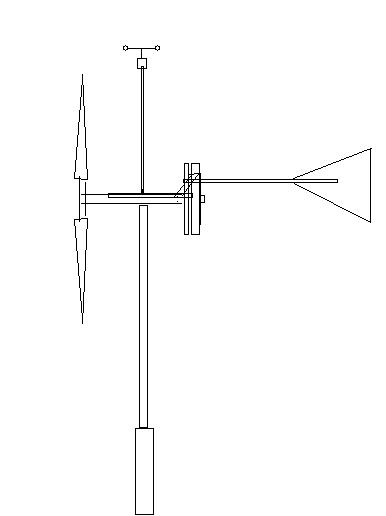

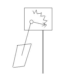

KiwiJohn
Joined: 01/12/2005
Posts: 691
Posted: 07:01am 29 Oct 2007
Gordon,
what I had in mind was a pole sticking up above the rotor disk with the anemometer on there.
The second diagram is of course the very simple vane and potentiometer anemometer. If it is not mounted on the mill it would of course need its own directional vane to keep it into wind.
GWatPE
Joined: 01/09/2006
Posts: 2127
Posted: 08:42am 29 Oct 2007
Hi KiwiJohn,
the left diag would require a hollow shaft for the yaw box if I am not mistaken.
I am sure the vane would have a very non linear response.
I have checked the DAVIS cup anemometer and the output is not usable either.
I may resort to a heath robinson design using a bearing assembly from an old hard disk.
cheers Gordon.
become more energy aware
