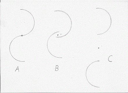

Correct me if I am wrong
A VAWT with the blades mounted in the full S shape spins slower but develops more torque (A) than (B)
A VAWT with the blades overlapped spins faster with less torque (B) than (A)
Will a VAWT with the blades separated by the width or twice the width of the blades turn more slowly but develop more torque,(C) than either (A) or (B)
Purpose:- Diaphragm pump. Slow powerful turns to reduce hammering/wear of valves
The fact that the blades are further from the central point must produce more leverage, yes?
Could this be called a greater swept area?
I accept more difficulty in construction
I have drawn the blades for clockwise rotation when viewed from above as to suit the direction of whirly winds and cyclones in this southern hemisphere

Hi, this is a silly video I made a few years ago, It may give you some ideas. Basically I found I had better results with more blades. What size is your project? What is your average wind speed? I can only suggest make it as large and as low cost as possible.

Hello everybody; It has been so long since I have been on this great forum. Very glad to be back. I agree with Gismo...and keeping it balanced is a real trick. Unless a guy - or girl, has access to manufactured and balanced blades it will be difficult to keep the thing together. The fair sized ones like mine do ok, but you will need a REAL GOOD Break system to stop it in higher winds. Just unbelievable how much torque this thing has in a 25 plus mph wind.

I have written two public reports about vertical axis windturbines, KD 215 about Darrieus rotors and KD 416 about drag machines. I advice to study these reports first if you have plans to build a VAWT. These reports can be copied for free from my website: www.kdwindturbines.nl
