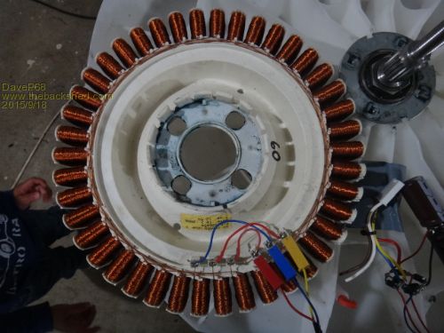

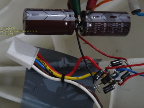

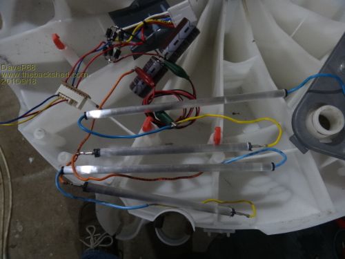

Posted: 02:26pm 17 Sep 2015
Hi
Here are some photos of my setup, a standard F&P washing machine bowl removed from a MW511 model.
All I've done is to mount different stators to this same bowl with it's bearing & shaft.
60 series 42 pole wired in delta mode. Note this isn't the same stator used testing the black rotor cap. Rotor cap isn't on in this photo.
As already described, use a 1200W drill to drive rotor cap.
All very simple set up just for testing power output into resistor load only.
David
