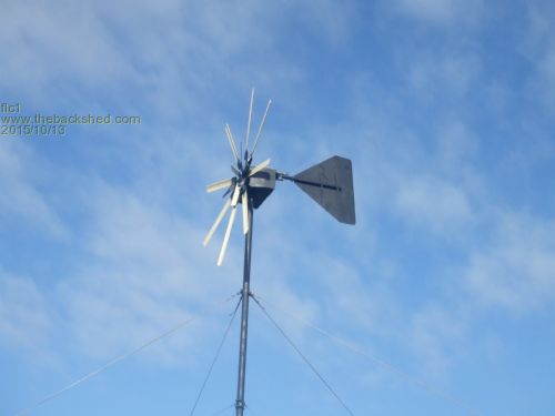

have finnaly finnished developing the right stator setup for my windturbine, it is a similar setup to what Davep68 has decribed, I wish I had seen his test results before I started building mine, I must have pulled down my turbine 10 times in the last year or so to test diffrent stators etc, anyway,,, now I have installed 2 x .6mm 36 pole stators, the first is direct drive and is electrily cut in half,with each half wired in delta, cutin rpm is approx 140rpm, the second stator is cut in 3/3 ,and each third is wired as star, and it is geared up 1.5 times, to cut in at approx 75 rpm, both stators are fitted with the black rotor caps,with the stronger magnets, there is a slight loss of rpm in light winds due to the extra loading from the stronger magnets, but a large gain in power once the windspeed increases, I have gone away from useing the 42 pole stators as there always seems to be more cogging with them when compared with the 36 poles, even after decogging. The turbine has 8 blades ,with a diameter is 2.4 meters,with a swept area of aprox 2.3m, peak rpm is approx 500 rpm it is useing a 1000watt 45-90v dc input gridtie inverter.So far it has reached 855 watts on the ac output side of the inverter, so thats about 925 on the dc input side, and the turbine was nearly at its furling point, so I hoping to get about 930 peak ac output when turbine starts furling, finnaly I am happy with the output of the turbine

Just an update,turbine has recently put out 957w ac, ,, more than expected, I did'nt see if was furling, not at home at the time.

latest output is 1017w ac
