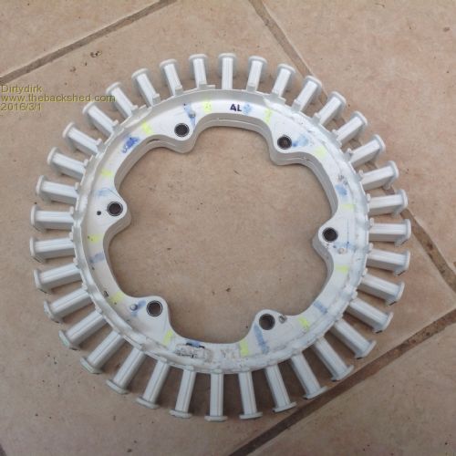

In the UK all staters have aluminium windings so are hard to reconfigure,I am therefore thinking of rewinding the coils with copper wire . Q should I rewind with the same gauge wire or go thicker or thinner

Weird that UK LG uses aluminium, would love to see some pictures.

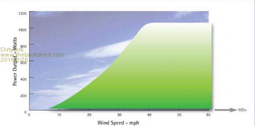

Pacwind Seahawk

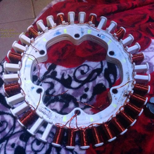

Starting the big rewind 1.6mm

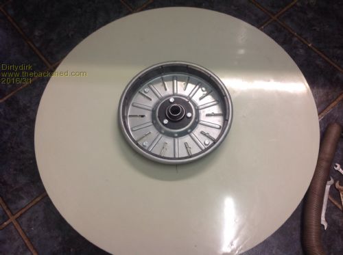

The hub on the bottom plate of my Seahawk/packwind vawt

Got to stop got a blisters on my fingers 42 turns per coil 1.06mm

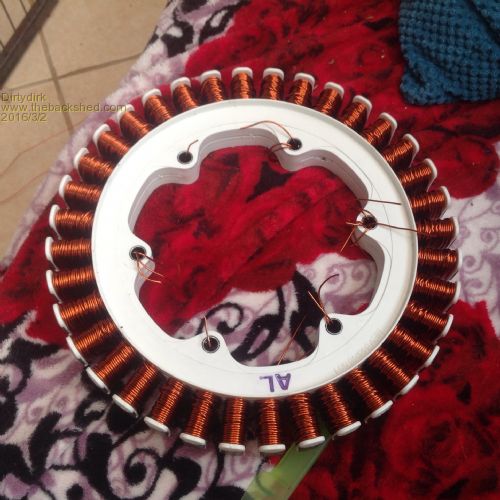

Posted: 03:26am 02 Mar 2016
We'll I'll never do that again
Coils are a bit scrape but should do for now
Going to give my fingers a good restEdited by Dirtydirk 2016-03-03

Posted: 04:52am 02 Mar 2016
Well done! Keep us posted on your progress and findings!
You are better off using copper since you can get away with slightly thinner wire. The norm is that copper cross section can be 20% less than cross section of aluminium due to better conductivity.
