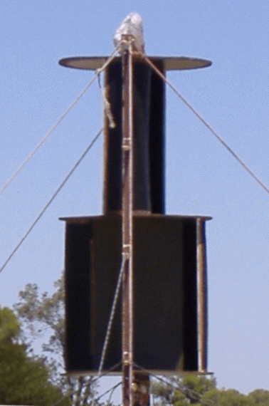

One way  to have multiple stators/rotors is to use one F&P unit on each end of a Savonius setup.
Notice the top of a unit I am working with at the moment, a second rotor and stator could be put at the top, for low wind speeds rectified outputs can be in series, higher windspeeds, they can be put in parallel.
