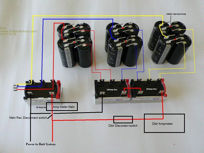

The illustration below is how to correctly configure the DC Caps , by putting them bac to back -++- or +--+ in this configuration turns them into an ac capacitor , The Capacitance Value will be ½ that of what is on the individual Cap , so if we have a 680uF 230V then it becomes 340uF 230V when reconfigured to AC Coupled . Higher voltage caps must be used that will clearly give a margin of safety if the mill becomes unloaded. People have used little uF / voltage caps and wonder why it doesn’t work.
Yes , 48V it works better but 24V is easily done .as well . I mostly use 1600uF 250V Caps back to back so 800uF , this works very well with Huayas / Exmorks , First winds …. as they all have around a 200 Rpm Cut in , they also work well with the F&P ( Correctly rewired again around 180 -230) , AXFX .

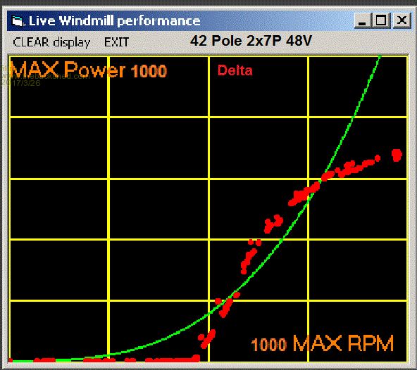

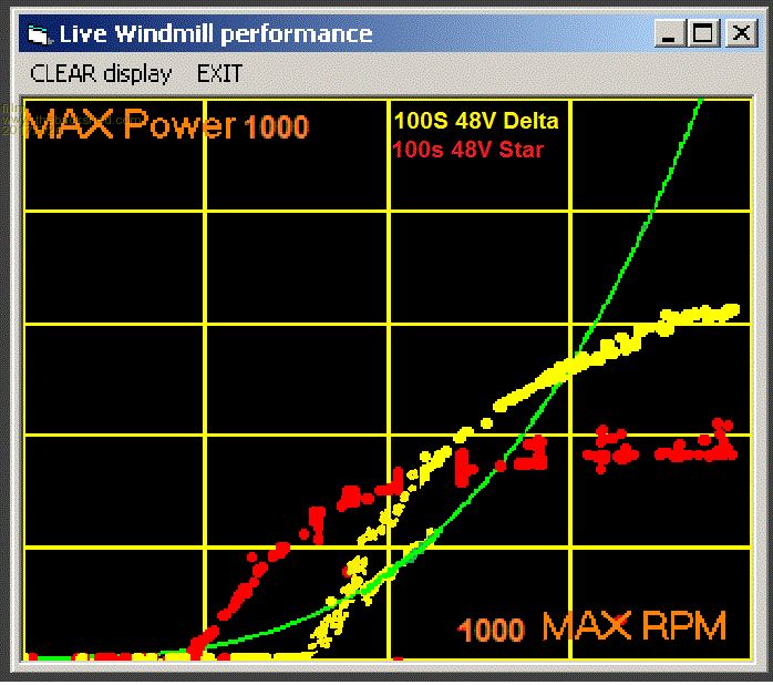

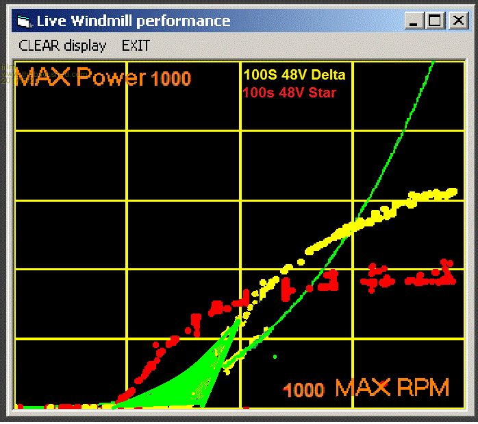

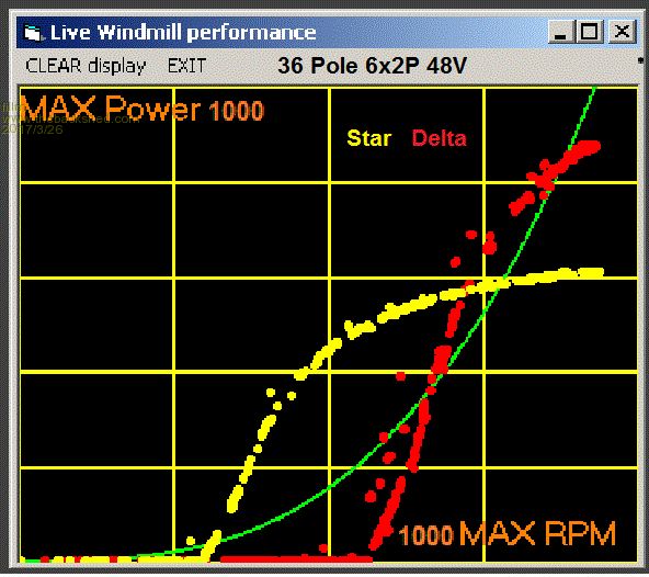

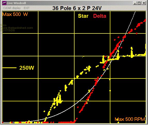

Below is a good example of what the doubler can do , the red trace line is on the right logger is a 2kw Huaya with the 3.1M GOE222 . It can be clearly seen the curve up to the point where the main rectifier starts at normal cut in. What it also shows is a complete shift in the power curve. These are 1600uf and the blades are still kept in a good operating range. The Left is the identical with std 3.2M Fiberglass blades , putting a doubler of this capacity on this would be detrimental.
As I have pointed out before, if the blades can give power and you don’t over load them it can work perfectly . BUT also what gets given in better low wind also limits high wind performance, that can also be seen above.

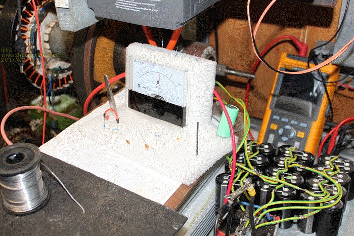

I have done some retesting on my test bench recently to see what the Black Cap rotor , these were done up to 960RPM on a few different configurations 6x2P 4x3P and even 12x 1pole and as Dave has stated there is an increase in power over a 100S , Yes there is but it definitely does not rule out 42poles as a waste of time . If set up correctly as a dual both will perform the same I given the same blades and matched winding resistance. The black will output more in higher wind speed.
In reality with a F&P dual powered with the GOE with black rotors or 42 pole at over 2.8m Blade and not severely over loaded there is no problem with outputting very good power and with the right combination of I can easily see 1.5 kw @ a 48V system and a bit lower for 24V AT Rpms in excess of 800Rpm . If you have ever been close to one doing that it’s a scary site.

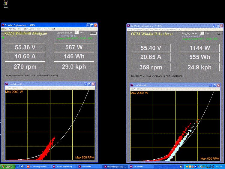

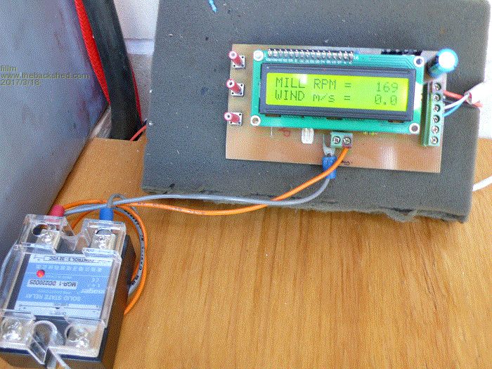

Below is a pic of a RPM & Wind speed monitor that Pete is the brains behind. It can also switch a relay at a given RPM but he modified the program to be NC until a set RPM. Here I was playing with turning the doubler off at X rpm and this allows a bit better upper output. That’s as far as it got and lives under a bench.
In real world it comes down to simple and effective matching of blade power to the alternator, chasing the “ IT Can Do XXXXX Watts “ is good to say but in reality count the number of times your wind turbine is sitting at that level . Although some do have serious wind lucky in some ways but it can be tiring I am told, but generally if you have a steady 15 ~20klm Average you have a good site.

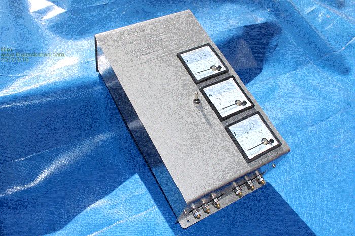

Below is a complete Capacitor Doubler I have done for some in the past, re-badged as the “Capacitor Power Maximizer “ and it has all contained in and gauges on both . The doubler can be turned off just to show it works.
IMO , Capacitors and other forms of improving performance ,star delta switching , higher voltage MPPT… etc Axial Flux is for certain types a hobby / enthusiast and if you want to do it that’s your choice . But if you want to use capacitors then I hope this has helped and to make it work better.
I do have some stock of the 1600uF Caps and they are more than sufficient for most applications and are a bit more on budget , contact me if interested. Forget it if you are using PVC pipe blades, it will stall .

The "Capacitor Doubler" does a great job by acting as a 'Load Adaptive Impedance Matching' circuit to a loads like a battery, as per what Gordon discovered. He also stated that they were a good substitute to using complex MPPT buck converters etc.
The way I use Gordon's 'Capacitor Doubler' circuit is by correctly matching the capacitor reactance values with the impedance of the stator. In doing so I've been able to extract 1.4 W per RPM in the 300 to 500 RPM range. Example 700 W output at 500 RPM, I've never seen any data/results get to that power output from a single stator of this website.
Stator impedance is derived by know the original Star resistance between phases, which for a 36 pole copper is 32 ohms. If a change to Delta is done, then divide 32 by 3 and the new impedance will be 10.7 ohms before any rewiring is done.
Then every time the stator is re wired you square the number of times "it is cut" i.e. "2"x 6p will be divided again by 4 or "3"x 4c will be divided by 9 or "4"x 3p divide by 16 or "6"x 2p divide by 36 and last "12"x 1p is divide by 144!
Once the stator impedance is know then the capacitor value is derived from a formula of Xc=1/(2xPIxFxC), but this needs to be rearranged to derive the value of C.

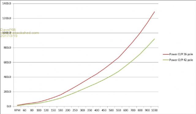

I've never said that the 42 pole stators are waste of time, so not sure how you got that impression? Did say I wasn't going to do any more testing on them as found their limits and just prefer using the 36 pole copper.

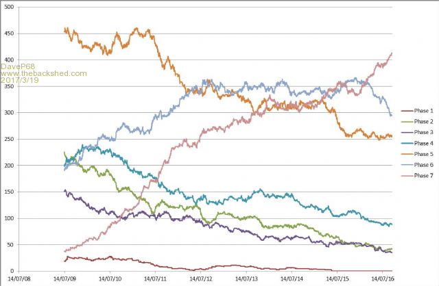

As you will already know I service the very F&P washing machine all these stators come from and below is a graph of numbers of machines I've seen over 9 years (rolling annual total) as per each version made. You must have a big stash of the 100s, as I haven't seen one of those Phase 1 machines for 2 years. The 80s (Phase 2-4) are still around in good numbers as per the graph 12% of total units I've serviced in the last year.
The Phase 7 machines that have the 36 pole copper stator account for 35% (Have removed Phase 8 + Phase 9's models from graph as they have Aluminium stators which are of no use).
My advise is to start switching over to using 36 pole copper stators, as you are going to be forced to sooner or later.

You state that you 'think' the difference between the 36 & 42 pole stators is 30% tops?
Be very interested to see your actual test results i.e. Volts/Current at what RPM etc?
Also Have you put up a Dual 36 pole copper with Black rotor caps of on a Turbine and measured the power output difference with your current 42 pole Dual setup?
I would have expected you to have built a 36 pole Dual with Black rotor caps, as you are a "Guru" on wind turbines and have all the instrumentation to verify the results.
My test results show into the "same load" a 36 pole copper stator with a black rotor cap will produce 40% more power than a 42 pole stator over the same RPM range (60 to 1155 RPM). Refer to the graph below showing difference in performance between the 36 and 42 pole stators.

Just built a 'Capacitor Tripler' and got 510 W output @ 300 RPM using a 36 pole copper stator wired 6x 2c Delta with a Black rotor cap.
This can be used on a 48 V battery system as it puts out 59 VDC at 8.65 A, so better performance at 300 RPM and could be used with say 3 M blades.
Using a Dual set up with a different stator for a cut in of around 80 to 90 RPM it should be possible to extract about 1 kW at say 350 to 400 RPM.
It does require more torque to drive at this lower RPM so unsure how efficient the power transfer is, as that hasn't been checked yet.
The capacitor values have to be chosen carefully, as the capacitive reactance has to be matched correctly to the stators impedance to get best results. Also it does have a peak operating range from 200 to 400 RPM, above that power extraction levels off but does still increase at a reduced rate of > 1.2 to 1.

At no point did I make reference to what an F&P 36 pole copper would do compared to a 42 pole on the same set of blades side by side.
All I made reference to was for the same "RPM" the 36 pole copper with black cap "correctly load matched" will give 40 % more power output than ANY 42 pole stator.
If you put a 36 pole stator on a wind turbine with a larger diameter set of blades you will get more overall power output than a 42 pole. This is due to the increase in blade diameter will result in a lower RPM, as you will will know. So a 36 pole copper stator will be able to output more power (correctly load matched). The 36 pole stator set up correctly has more power output potential than any 42 pole.
  fillm said   And in that condition it outperform the best 42 pole by 40%, fair enough that is your opinion and it probably is a fact.
It's not my opinion it's just a fact.

Will supply some pictures later as the post is getting a bit too long...

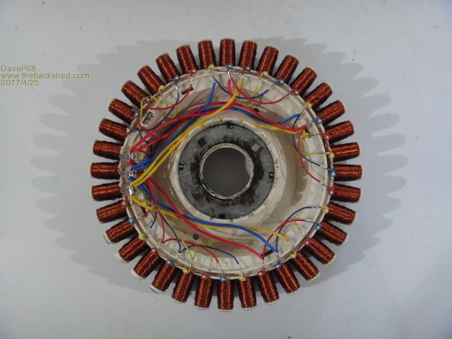

Phill are you sure you haven't set up this Dual black as a 12 x 1p Star? By my calculations from all my experience of these 36 pole stators you should be getting 3.2 kW of power to fast charge your lithium batteries.
  fillm said   So did some tests on your Cap Calc Recommendations - Stator 6x2P 1600uF AC Cap Dblr , not sure if you want the results.. That's a 10A gauge from the dblr into Lithium ... and its also data logged
Looks to me you did the same here too, the stator in the above photo seems to be wired 6x 2p Star. That will go a long way to explain the Amp meter reading of just under 6 Amps.
My set up clearly stated to use a 6x 2p Delta to get the 59 VDC at 12 Amps. My own test results from yesterday prove I was correct all along. The capacitor size didn't matter so much after all if the stator was correctly set up in the first place. Understanding these F&P stator matters if you want to get the best results from them.
In case you need to see how to wire a 6x 2p Delta stator I've included a photo of how I wire mine. The colour coded wiring does make it much easier to do.Edited by DaveP68 2017-04-28

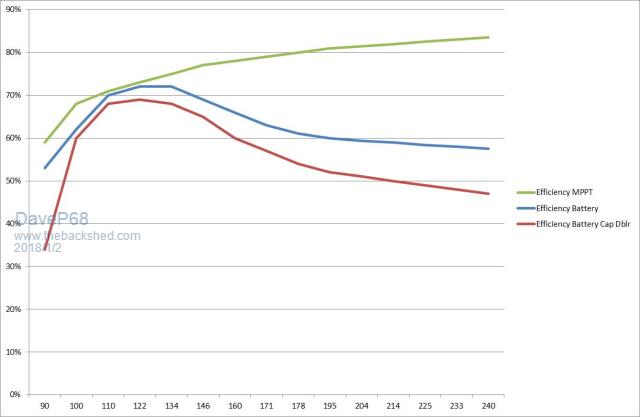

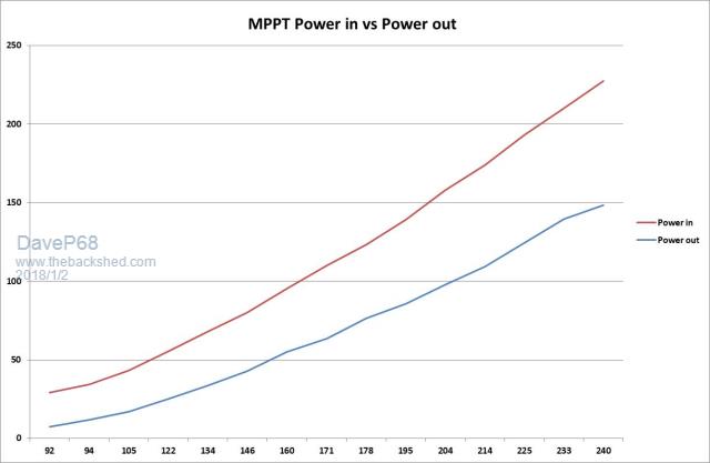

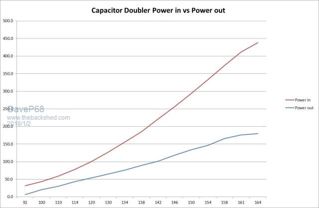

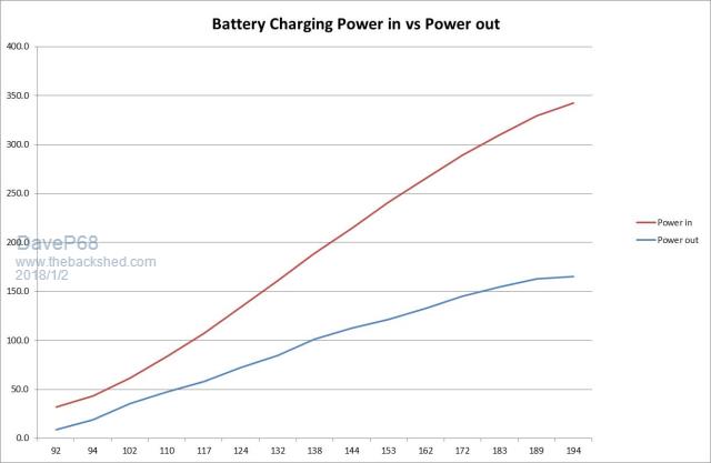

Phill would like to ask if efficiency graphs like this one were ever logged back when all the extensive testing was done on Capacitor Doublers by you and Gordon?
There is a problem with Buck / Boost converters if not set up correctly will take too much current from an F&P stator and limit the voltage rise to the level it needs to go to.
Was it a true comparison to made between a MPPT Buck / Boost solely for wind and a capacitor doubler on 2 identical wind turbines in every other respect?
  fillm said   When I get time I will put all the graphs along with the efficiency torque curve that gives the correct input power.
Phill did you ever get around to graphing the efficiency torque curve that gives the "correct" input power?
Here are 3 of mine so interested to compare what you are able to show from your test rig.
Note the worst result comes from the stator connected to a capacitor doubler!
