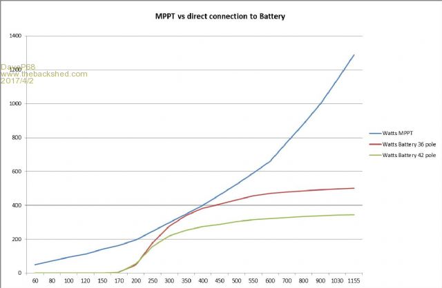

In summery these stators like to be matched to a load which increases in impedance with a increase in RPM which allows the voltage to increase at the proportional rate. The capacitor doubler circuit set up correctly helps a lot but it to has it's limitations.
Refer to the table below for how MPPT actually works on these stators. Please note no reference is made to RPM.
Having done most of my testing with 36 pole copper stators with black rotor caps I find them the best. That is due to them being 'Factor Decogged' and having 12 poles per phase they can be re wired into more combinations 1x 12p, 2x 6p, 3x 4p, 4x 3p, 6x 2p & 12x 1p. The 42 pole stator can only be wired into 1x 14p, 2x 7p, 7x 2p, 14x 1p.
With the above conditions met the 36 pole copper stator can output 41% more power than a 42 pole 60s & 80s and 47 % more than a 100s for the same RPM.
I'm not saying the 42 pole stator are no good, just pointing out their limitations as they are after all older older technology.
It's a good thing to embrace progress as when the 42 pole stator where in production we lived in a world with no smart phones :)

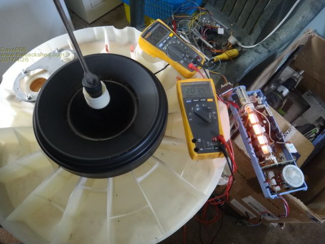

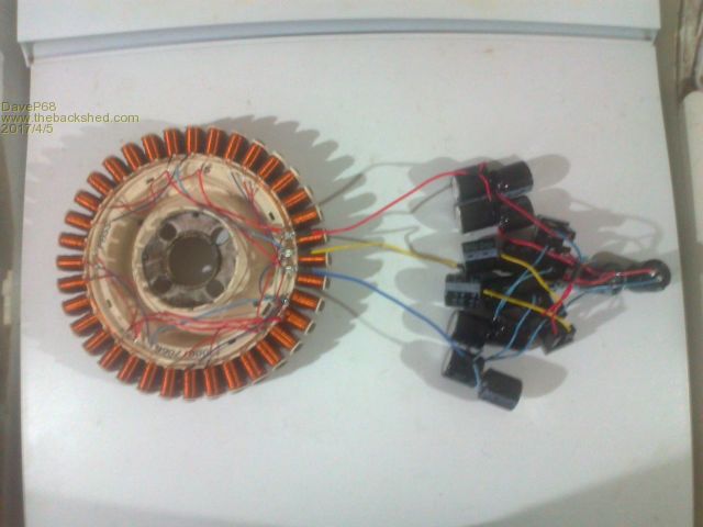

Refer to the Photo of my crude setup which isn't as tidy as Phill's.
The capacitors are 280 uF AC (2x 560 uf 250 VDC). Voltage was 87.5 Volts at 8 Amps. Fred has a 45 - 90 VDC input Grid Tie Inverter so that is why I did it in that configuration to prove it would be compatible for 1 of three different stators he plans to put on his new Wind Turbine build.
  fillm said   So did some tests on your Cap Calc Recommendations - Stator 6x2P 1600uF AC Cap Dblr , not sure if you want the results.. That's a 10A gauge from the dblr into Lithium ... and its also data logged
Yes Phill there was an error in the calculation putting the capacitor value at 3x what it should be. Yes we all can make the odd mistake, but in this case it lead me to getting even more power than before!
So please try the test again with the same stator this time using any value from 400 to 560 uf AC capacitors. Depending on what capacitors of that size you have on hand and report back with results. Calculation is for 560 uf so use that value if you have them or just under that.

Have done some other testing on a 100s Delta with different capacitor doubler, this time with 135 uf AC capacitors and got 543 W @ 455 RPM. The other readings of interest to Phill are 59 VDC at 9.2 Amps. Reason I did the test on that setup is that I didn't spend lots of time re wiring an 80s into 7x 2p.

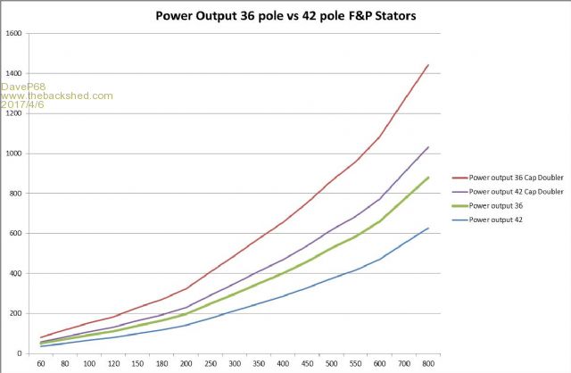

Yes the 42 pole stators can put a bit more power out than I got before due having the corrected capacitor values in the capacitor doubler, now that I've fixed the error in the formula.
Here's a graph with revised output data 36 with black rotor cap vs 42 poles.

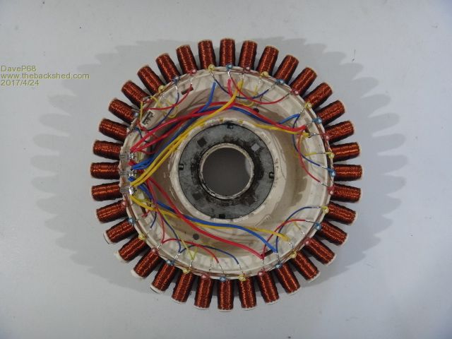

An update on this topic, is that I've re wired a 36 pole copper to 6x 2p Delta with a black rotor cap. Correctly load matched via capacitor doubler confirmed what I've stated before that it can output 708 W @ 430 RPM into a battery 59 VDC at 12 Amps.
The capacitor values ended up close to what I recalculated at 600 uf AC, but 560 uf also outputs about 10 W less at same RPM.
  fillm said   But if the windings are not .8 or 1mm then I would think the output would be limited in real world testing and if it gets over 400W I would be surprised
Phill are you still surprised? Or now except that the 36 pole copper stator with the black rotor cap is just a better stator.
Here is a photo of the finished stator re wire (note the coloured coded wiring).
It looks like a birds nest but works as predicted.
Yes they can be a bit harder to re wire with 0.6 mm conductor size and goes to show that wire diameter doesn't limit the current.
I only use Delta mode which produces more current, but less voltage.
Please refer to my topic on F&P stator wire diameter as the extracted power output is a bit better on 0.6 mm stators.Edited by DaveP68 2017-04-25

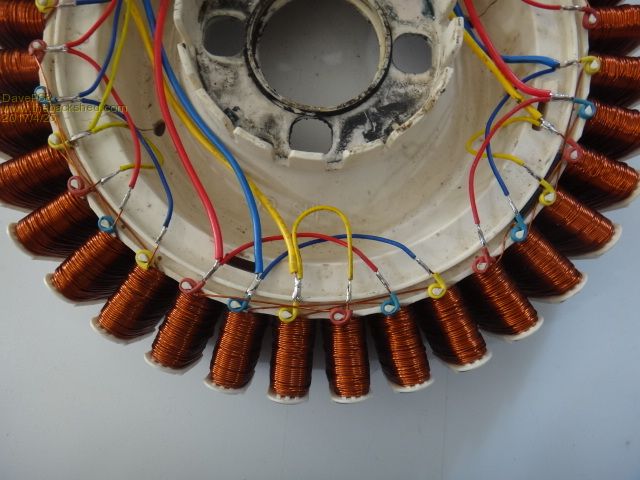

Delta connection does have one potential problem, in that if the three waveforms are not very pure distortion free sine waves, and exactly 120 degrees apart there can be circulating currents between the windings that can result in overheating of the windings and loss of output power and efficiency.
You can check for this by opening the delta loop and measuring the voltage and circulating current across the break. In a perfect world both voltage and current should read zero.
If there is significant power across the break, all that is going to do is heat up your windings for no useful purpose.
Commercial alternators are always star connected for that reason, but as you say, Delta can still be very useful because it produces a lower dc output voltage and a higher current from a rectifier.
There is a safe way to still use Delta by breaking the delta connections in one place around the closed loop, and using two extra diodes, called "broken delta". Google should find you some references on that.
Here are a few variations on three phase rectifiers you might like to try.
The fourth circuit produces exactly twice the dc output voltage without requiring capacitors.

Here is a close up of the wiring configuration on that 36 pole 6x 2p Delta stator.
Note the wire lengths are all the same on connections phase to phase "Red-Blue, Blue-Yellow, Yellow-Red". This keeps every as uniform and/or symmetrical as possible. If there was even a small current flowing when output is open circuit I wold notice it as a form of cogging even at low to medium RPM. Have noticed anything like that so far.
I'm still going to take your point on board by opening the delta loop and measuring the voltage and circulating current across the break.
Will let you know these results too.

No way of really knowing for sure, but open the loop and see what is there. Then you will know for certain if there is a problem.

Did a tests on 60s, 80s & 100s all wired delta. So with an opened loop, measured the voltage and circulating current across the break.
Test results all done at 500 RPM are as follows;
60s 36 pole With (black cap) 5.6 VAC open loop. Closed the loop 53 mA circulating current.
60s 42 5.95 VAC open loop. Closed the loop 38 mA circulating current.
80s 42 3.9 VAC open loop. Closed the loop 52 mA circulating current.
100s 42 1.5 VAC open loop. Closed the loop 130 mA circulating current.
Now here comes another interesting part. Did same closed loop test with a 100s into a matched load 500 RPM. Got 3.9 Amps AC for 9.15 Amps DC out of the rectifier.
This is the amount of AC circulating current under optimum load conditions going through each pole. Did the math for total heat build up under load for all 42 poles which came to 59.3 W. This is about the same as another measurement on a 36 pole delta under load I did a few months ago came to 63 W.
Hope this is of interest to you and others as goes to prove not much power being lost. This may due to how I rewire my stators in Delta configuration.
More results to follow once I've tried out your alternate rectifier set ups on delta wired stators
David

Not sure if you have read the old topic Star / Delta Controller ? Dates back to mid August of last year.
Have a new approach to this concept using a 36 pole stator 4x 3p Delta but with 2 outputs feeding in 2x capacitor doublers.
Each capacitor doublers can then be high speed switched using FET's to put the outputs in series 2x 6p or parallel 4x 3p at a 260 RPM switching point RPM going up or 200 RPM going down.
Example;
The default state the switched stator is ste to a start up is 2x 4p with o/p's of cap doubler in series and cut in is around 80 - 90 RPM. It's peak current in this mode will be 4.5 Amps. At 260 RPM 4x 3p delta 57 VDC with 6 A ~340 W.
Meant time the second stator set up as a 6x 2p delta is cutting in at 260 RPM with same volts with 3-4 Amps. At say a peak of 500 to 550 RPM the current will be at 22 - 24 Amps which could work out to be a power of up to 1250 - 1400 W form a dual stator on a 2.8 - 3 m set of blades.
The FET's need to be high power fast switching and very low on resistance, with a make before break switch over so stator doesn't see an open circuit condition.
There is a bit more to the switching system than what I've explained here. As the make before break will put the switching stator into a resistive load at change over so things don't get carried away voltage wise. Also the switch back happening at a lower RPM of about 200 RPM using a form of hysteresis.
This configuration will provide the best load matching set up to a 48 VDC batter system so no stator goes into saturation.
Got some of my new inspiration from what you posted back on 4 April using an a feed forward system with wind speed with an anemometer quite independently of the main wind turbine.
What are your thoughts?Edited by DaveP68 2017-04-26
