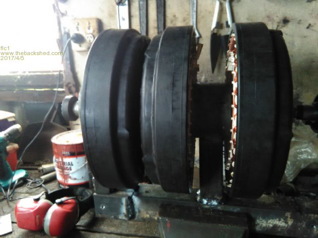

Start of a new wind turbine useing 3 x f n p stators, all 36 pole copper with black caps.
Will use I think 5 of the GOE222 blades that we got from Phill.
Each stator will probably have a cap doubler fitted and I will mount it on the same tower and use the same base frame and tail from previous dual stator that is up and running at the moment.
I will enlarge the tail fin size as the blade diameter will increase from 2.4m to 3 or 3.1m.
Looks all good in theory fingers crossed ,might be diffrent when complete ha!
May end up being just another double with 3 blades,and cap doublers easier to build.

Hey Fred
That set up with those GOE 222 blades plus capacitor doubles should output around a peak of 2.4 kW! It's going smash that old F&P dual of yours out of the park.
