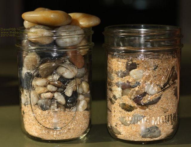

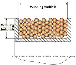

There seems to be a bit of a misunderstanding of how wire diameter affects the power output and/or efficiency of F&P stators.
Yes thicker the wire the higher the current output but lower the voltage output of the stator. So the 100s has the larger wire diameter of 1 mm.
In fact the most efficient stators, that also put out more power are the 60s 42 or 36 pole copper stators.
The main reason for this is how much the total volume of copper that can be wound on each pole.
Please refer to the pictures below.
Notice the air gaps between the wires of this coil cross section.
Now your probably thinking I'm nuts showing you 2 jars in the lower picture with small rocks, stones and sand. What these illustrate is that as the wire diameter is made lager the air gap between wires grows at a disproportionate rate. So if we fill a jar with just sand most of the space is taken up. Hence 60s stators have 0.6 mm wire diameter so are closer together with less air gaps.
So from the measurements I've made on the same rotor cap (magnetic field constant) when correctly load matched the 100s puts out 5% less power than a 60s re wired in such a way that the voltages and currents are similar.
Example 100s star is 2.6 ohms from phase to phase. A 60s 42 pole re wired 2x 7p Delta is 2.667 ohms from phase to phase. That's about 2.5 % difference so voltage and currents will be close enough for comparison. When the 2 different stators power outputs are measured at the same RPM the 100s is about 5% less.
So it shows that lager wire diameter does not translate into higher output power.
Also the cogging on the 100s is more when compared to the other stators. Yes they can be decogged but not as well as The 36 pole comes factory decogged. This which makes a difference in low wind performance.
After all Fisher & Paykel went to the smaller wire diameter for motor drive efficiency, so that fact works both ways if you want to make power from them!
Hope this information is of some use to anyone that visits this post.Edited by DaveP68 2017-04-07

A larger number of turns of fine wire can certainly pack significantly more copper into a given fixed winding volume. The main difficulty with that is your extra power then comes out at a higher voltage with reduced current capability.
That problem can easily be overcome by winding on multiple strands together, so there can effectively be two or three windings of identical turns count, connected in parallel.

Your photo caught my eye. I had a high school physics teacher that approached the podium at graduation with two similar jars. A slightly different take, but his point was that if you spent all your time on the little things that fill our days, you don't have room for the important (larger) things in life. He's, to this day, still one of my favorite teachers. Thanks for the visual.
