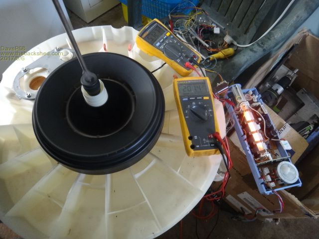

For a day job I repair these boards and need to activate this function as part testing the motor control module.
Here is a photo of a modified module used as a load at 900 RPM 1000 W of energy being extracted from the stator.

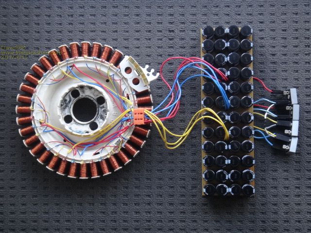

The proposal I have is to use a capacitor doubler to extract maximum current out of the stator before the core becomes saturated. The trick is to extract maximum power from say 2 stators on the same shaft when a peak RPM is reached. If more power is taken from the shaft than the blades can deliver we go into a lower TSR range. That way a controlled shut down can be done before the wind gets too strong.
This requires some fine tuning in terms of a workable system, but from some testing I've done with one stator it should be possible.
With this separate cap doubler (one for each stator) is used for braking only when running in over drive mode on a 36 pole 4x 3p Delta I get 72 VDC 16.4 Amps 1.18 kW @ 550 RPM. Thing is the shaft power required to drive the stator is >2 kW. That is from just 1 stator! This same stator when not used in braking mode would normally be charging a 48 VDC battery system. The same system can be set up for a 6x 2p Delta, with the brake operating at 48 VDC 24.6 Amps peak at brake application.

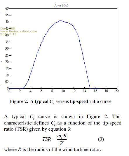

For those that are interested in following this topic on F&P Electronic Dynamic braking, have now got the circuitry working that can perform this function.
Doesn't require any complex electronics like a microprocessor, just a bunch of op amps!
Will publish the circuit diagram once I've done some fine tuning to how it will operate in the real world. This will soon be tested out on a real wind turbine.
This circuit can be adapted for use on basically any PMA including an axial-flux unit(s).
Have a furling system as a backup is a wise choice, so not trying to say that that function has been superseded.
Just like the concept of a fully automatic system that requires no manual input from the end users perspective.Edited by DaveP68 2017-06-22
