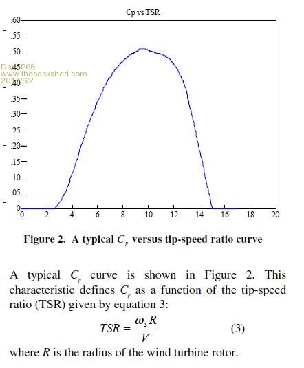

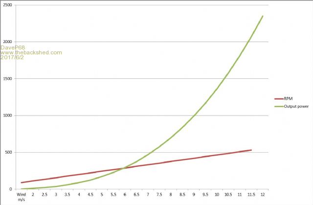

Thanks to you both of for your valued input. Have heard of the Aurora inverters, but have never seen one in operation. I also do think that a an independent anemometer that rapidly tracks wind speed will help to keep things in check.
Here's a clue to where I'm coming from with this matching of the PMA's electrical characteristics to the 'Tip Speed Ratio' of the blades. TSR directly converts to RPM over a fairly linear range of operation.
Refer to this graph that I've posted in the past.
Here is how TSR can be calculated.
Lots of work to do, but it will be my next project now. Pretty well finished testing F&P stators for their full electrical characteristics. That part had to be competed first...
