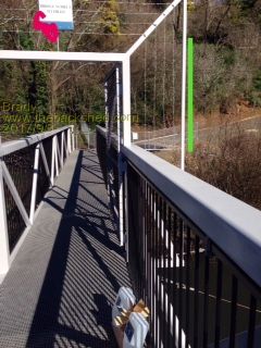

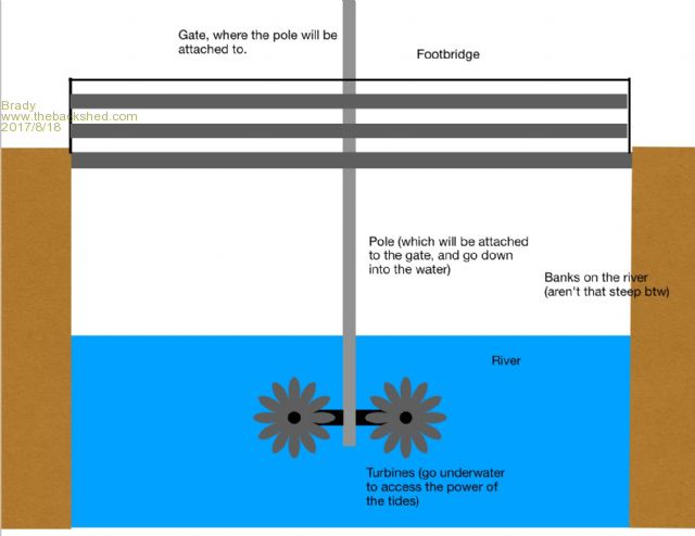

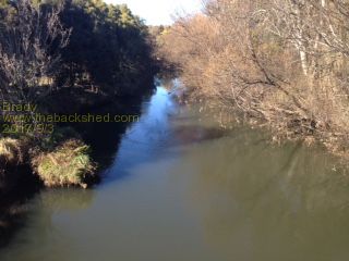

Let me describe the river before I get into the design of our system. To get across to the other side of the river there is a small footbridge. In the middle of the footbridge is a gate, which only the teachers can unlock. The river itself is relatively wide, but the banks are very difficult to access due to a lot of bush and mud. The most powerful part of the river is in the middle of it, which is hard to access from the banks. Conveniently, the gate of the footbridge is just over the middle of the river. Remember that, because it becomes important to our design later on.
Here's a picture of the design we are aiming for
The pole will be attached to the gate, and it will go down under the water. Under the water, on the pole, will be two turbines. Both will be powered by the tides, and we hope to be able to charge a battery. Keep in mind, the is only a school project, it's not going to be titanic in size. The proportions in the image are VERY wrong, and it was only made to give you an idea of what we wanted to do.
Our knowledge of motors and turbines are very basic. From my knowledge, the turbine is connected to a large gear, the large gear is connected to a smaller one, to get to a higher rpm, which powers the motor. We are going to make these parts using a 3D printed That's all we've come to understand. Which is where I want your help. We want someone to explain to us, as simply as possible, how this all works. From the turbine design, to the gearbox, to motor and how they are all connected. Also, how would we water proof it? Could last overnight without breaking?
We would greatly appreciate a response, Thanks a lot for reading it all.

Before you even start, you need to find out two things.
1/ how much electrical power you need.
2/ how fast the water flows.
You need to find out how much capacity your phone battery has, and how fast you need to recharge it. Big difference between the amount of power needed to recharge it in one hour, and the amount of power to recharge it over several days or weeks.
The other thing is how fast the water flows. Is it barely moving, or is it like foaming white water rapids ?
When you know how much power you need, and how powerful the water flow is, only then you can begin to size the turbine.
Suppose it turns out that it needs to be very large, much larger than the depth of the water ? Or larger than you feel comfortable in building ?
So first we need to see if this is even practical.

You really need to find the flow as that will determine the power you will extract from the turbines
easiest way is to throw a stick (or anything else that floats) into the center, after having measured out a set distance downstream (say 100m) and time it from launch until it floats past the set marker position
Then you will need to find out the efficiency of your turbine prop and that will determine the size turbine you will need (flow rate will give your energy m^2)
The other issue is on a river speed of the flow will likely be fairly low most of the time, but alternators/gennies (unless custom built) will likely need fairly high speeds, requiring gearing- which makes it harder for the water to spin the turbine (it's more likely to stall the water directly in front and send most of the flow around the turbine- thats why they use dams as it forces the water to go through the blades)
You will almost certainly need to build a small scale prototype and use it to get base figures for your individual setup
I have seen plenty of people want to make something like this (I did when I lived on a local riverbank) but not many end up going ahead
Remember too that unless it is very small, considerable forces will be acting on your pole mount, so you will have to ensure the bridge itself can handle the load

Now I dont have to rush off to work, some more ideas about your gearing waterproofing etc
longterm waterproofing is a major hassle, if you just want it to run for a few days, then its easier
As you are looking at constructing the gears etc yourself, one suggestion I have (from a long time friend who is into microhydro) is keep the sparky bits away from the wet bits as he put it lol
He lost several installations due to creek flooding and now uses vertical drive instead- either a variation on Gorlov turbine with the axle extended above the waterline and possible flood zone. His original ideas were in fact very close to your own design, but long term waterproofing and maintenance stopped his following that route
As you want to use the pole mount and a horizontal axle turbine design and making your own gear to up the speed, why not think of a right angle bevel drive if you want to experiment with it- that way you keep the sparks away from the wet easily, plus it allows much easier or even no waterproofing required for the generator end which can be mounted up at the bridge end for easier access for modifications/maintenance
The bevel gear lets you turn the rotational axis from horizontal to vertical and also allows a change in gearing ratios (to help with speeding up to the speed of the genny)
The best bit is it will allow you to run an axle up inside your supporting pole and at the top, it pops back out- ready to either add/change the gearing more or mount the genny- safely out and away from the water- minimizing waterproofing needed
By making the bevel gear out of either non oxidizing metals (brass/bronze) or plastics, you minimise the lubrication required, and also the waterproofing needed at the prop end- in fact with the right design and keeping speeds down at the water end- you might find it possible to actually not bother with waterproofing at all and simply let the water flow through the gears and support bushes- acting as the lubricant (at slower speeds obviously)
This also has the advantage that if you dont get enough speed out of the turbine blades, you can add extra gearing at the top (belt drive or more cog gearing) to change speeds, plus you can easily get at the genny to maintain or modify it (or even swap over to a new design easily- build several different generators with different number of poles/permanent magnets/ electromagnets etc and by using a belt drive from the top of the axle, swap out each to find the different advantages of each- something not so easy to do with a underwater pod design

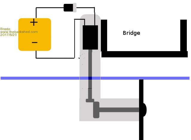

If using a DC motor in this fashion ie a generator; to wire it up you will need a 'anti motoring diode' otherwise when the flow rate is too low; the battery will make the motor turned into a genny back into a motor again and it will discharge the battery trying to push the river along faster!
To wire it up the motor/genny will have a + and a - connection; you will have to wire the motor - to the battery -, and in the + wire you will have to put a diode IN4004 will be fine for a small motor like the one mentioned before.
The diode is black and has a white stripe at one end- that end with the stripe is connected to the battery +, the other end without the stripe goes to the motor/genny + terminal
This stops the battery backfeeding or 'motoring' the generator when the flow is too low

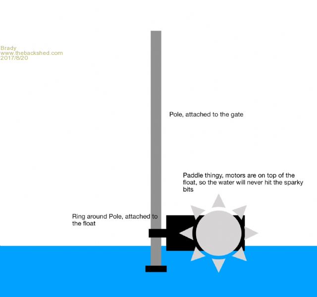

Just a suggestion for a slightly diffrent idea which may be easier to build?
useing your pole from your bridge ..mount a floating platform which can rise up and down on the pole,or have a swingarm, and on that platform you mount a paddle wheel, the same as you see on the old paddle steamer boats with gearing from pulleys ,belts or cog gearing.
Your generator is on the platform so its not going to be much of an issue to keep the water out of it,
you have a wide paddle wheel.. which will give you plenty of power to use with your gearing, just have to test what size paddle wheel you need in regards to how much flow there is in the river..... this is how I would do it .Edited by flc1 2017-08-20

Posted: 01:48pm 19 Aug 2017
  flc1 said   Gday Brady,
Just a suggestion for a slightly different idea which may be easier to build?
using your pole from your bridge ..mount a floating platform which can rise up and down on the pole,or have a swing arm, and on that platform you mount a paddle wheel, the same as you see on the old paddle steamer boats with gearing from pulleys ,belts or cog gearing.
That would be perfect if the water is fairly shallow and fast flowing.

A floating drum on the end of a boom, with paddles attached certainly sounds like an excellent idea.

I believe I will be able to access the river, either tomorrow or Tuesday. At that time, We will test the speed of the river. However, the problem is that the river fluctuates ALOT, and very adept to flooding. Sometimes, it can be calm, and relatively slow, while other times it turns into a complete monster! Especially after a rain storm. How could we measure the river speed with often fluctuations?
As for electrical power needs, we need to charge at least a battery with a MAh of 2000. But we can go as high as we can handle. In the end, we hope to be able to charge a battery, to charge a phone, from 0 to 100 percent. As for the phone I will be charging, it has a MAh of around 1500.

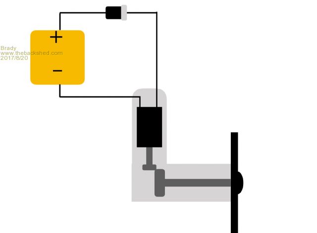

Ooh, and diode and weird bezel gear things. Like this?
The idea of using paddles and a floating platform seem like the easiest to make. Is this design possible?
I love the idea, keeping the generator out of water would been that I wouldn't even need to waterproof very much! I'll suggest it to my team tomorrow!

yep diode in the positive lead. And maybe look at a small charge controller to stop your battery from being cooked....not sure if they make them that small, or you could just go with small generator and charge controller and small 12 volt battery with small inverter to plug your phone charger into ha! unfortunatley it cost money , and would that be cheating?
That second pic you have there was what I was trying to explain...maybe make the slide ring loose and at the top of the float so its less likely to jam?, or use a swingarm? .

Wild unpredictable fluctuations in water height and speed, lend themselves to the floating paddle wheel solution. The simplest way might be a floating drum with paddles arranged around the outside.
If that was mounted on the end of a long forked boom, it could rise and fall with the water height and possibly even survive a fair flood.
The drum will need to be perfectly watertight or its obviously going to slowly sink.
Easiest way might be to just use a steel or plastic drum and bolt or screw your axle shaft and paddles to the drum and not worry too much about keeping the outer structural part of the drum water tight.
Then stuff the drum with small watertight objects to give it buoyancy. Maybe small plastic drink bottles? Whatever you can find that is both light and absolutely watertight, and you can pack a lot of them in there very closely.

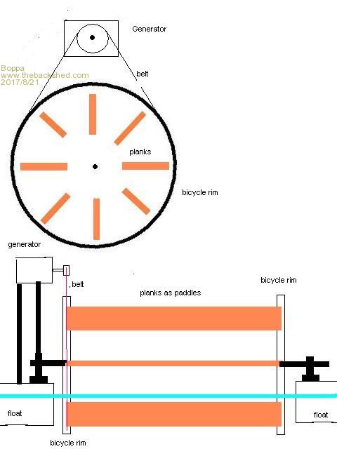

The paddlewheel is definitely a good solution and if you use a bicycle rim (a pair actually- one for each end of the paddlewheel) you could further distance your genny from the water, plus gear up to the speed required for the genny from the very likely lethargic paddlewheel speed by using the rim itself as part of the gearing- a rubber belt around the rim, and at the top it goes over the genny pulley, and you could attach the planks/blades to the spokes
re the first diagram
The motor would be at the top actually at the deck level of the bridge so easy to access, the axle and pole/axle tube would extend right down to the water and below

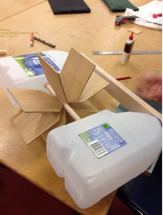

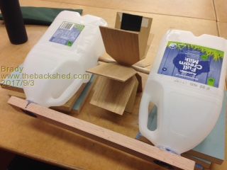

I found this thing,
I was thinking of something like that, but larger, and use those Water dispenser containers you find in offices.
I would place the motor in the middle of the two containers. I'm sorta confused by that belt system... But I found this video showing me how gears work and stuff, http://www.askaprepper.com/homemade-water-wheel-electric-generator/
Its the second video down. Do you think I could do something similar as that old man?
Connected through the motor would be the axle shaft, on either end, over the containers, would be the paddles (I really like the idea of using drums or bicycle rims as the paddle wheel, I'llsee what I've got access to.)
I'm going to talk with my team tomorrow about the floating paddle wheel idea, it sounds simpler to make.

And a suitable slim and very flexible multi groove rubber drive belt and pulley that should not slip, (even when wet) might be found in a discarded tumble dryer.
The drum in a tumble dryer is typically about 20 to 22 inches diameter, and the matching multi groove motor pulley maybe an inch diameter.
I believe BMX bikes typically run 20 inch diameter rims.Edited by Warpspeed 2017-08-22

I was thinking more along the lines of a sternwheeler lol
but the twin paddles would work too
paddles could be attached to bicycle spokes via nuts/bolts with large washers, or even with cableties....

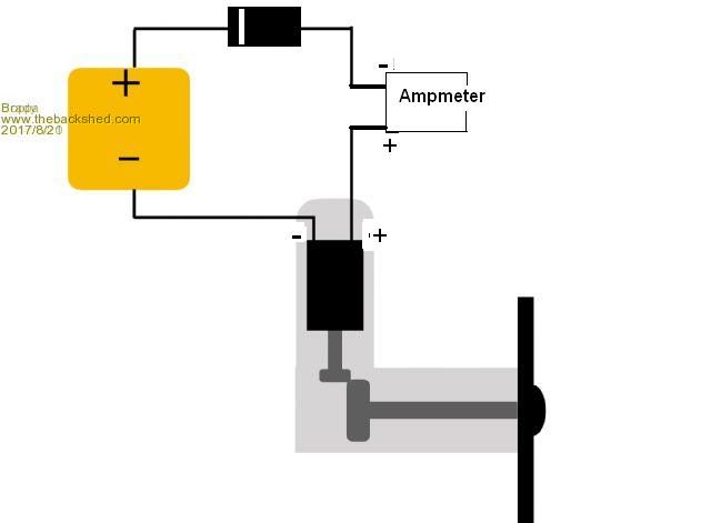

One thing you could do is measure the water speed, and if you put an ammeter in the lead to the battery (many schools still have them in the science labs I believe) if not a cheap multimeter with a 10A setting would work as well
Then you could chart various water flow rates with the current you get out of it

I just noticed- you have your diode backwards in the diagrams above- the silver/white banded end should be closest to the battery +, the unbanded black end would be connected to the motor +
