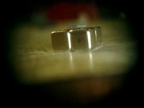

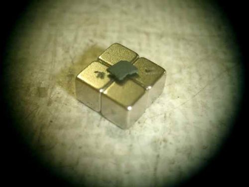

Then, every once in a while, you get that sudden magical feeling back yourself too...
The magic? Letting an object float in the air, using nothing but 4 NdFeB magnets:
Sheer wonder and amazement. In the past I had already seen the elaborate contraptions using Bismuth and a large stack of neo magnets to let a small neo magnet float in the air, but this one beats them all by sheer simplicity and ease of construction: just 4 N45 5x5x5mm NdFeB magnets and a thin piece of graphite, cut from an old carbon brush. They say to use pyrolytic graphite, but a bit from a carbon brush often works too. Some brushes work better than others.
There are plenty of descriptions of this and similar experiment around on the web. Here's the link where I found it first: http://www.supermagnete.de/eng/project70?switch_lang=1
I intend to build a larger and nicer version of the one I already made, to put on my desk.
It's things like this that make me feel like a little kid again, once in a while... The sheer wonder and amazement of it all... Truly exciting times we live in, with so much powerful technology at our fingertips.
